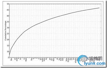

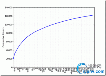

  Figure 1-4. Cumulative frequency plot for the 50 most frequently used words in Moby Dick, which account for nearly half of the tokens

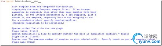

  原图纵坐标是百分比,我这里出来的是数量,查了下doc,发现貌似没有百分比的参数选择呀
