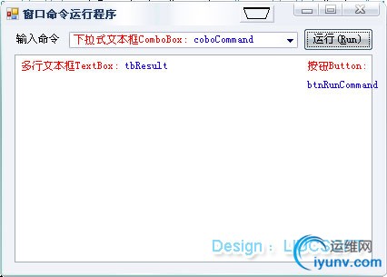

// 实例一:WindowsForm应用程序
// 代码如下:

namespace CommandTest
    public partial class FrmRunCommand : Form
        System.IO.StreamWriter sw;  // 定义输出流 sw 作为Shell的标准输入,即命令
        System.IO.StreamReader sr;
// 定义输出流 sr 作为Shell的标准输出,即正常结果
        System.IO.StreamReader err; // 定义输出流 err 作为Shell的错误输出,即出错结果
System.Diagnostics.Process p = new System.Diagnostics.Process();
        System.Diagnostics.ProcessStartInfo psI = new System.Diagnostics.ProcessStartInfo(System.Environment.GetEnvironmentVariable("ComSpec"));
      public FrmRunCommand()
            InitializeComponent();
      private void btnRun_Click(object sender, EventArgs e)
            psI.UseShellExecute =false ;
            psI.RedirectStandardInput   =   true;
            psI.RedirectStandardOutput   =   true;
            psI.RedirectStandardError   =   true;
            psI.CreateNoWindow   =   true;
            p.StartInfo = psI;
          Cursor = System.Windows.Forms.Cursors.WaitCursor;
          p.Start();
            sw = p.StandardInput;
            sr = p.StandardOutput;
            err = p.StandardError;
          sw.AutoFlush = true;
          if(coboCommand.Text != "")
                sw.WriteLine(coboCommand.Text);
            else
                sw.WriteLine("echo 未输入命令");
            sw.Close();

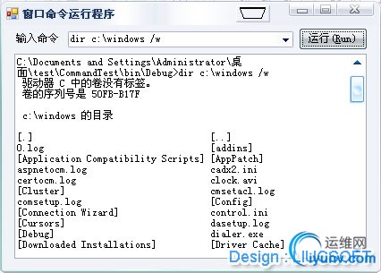

          tbResult.Text = "输出结果为:"+sr.ReadToEnd();
            tbResult.Text += "\n错误信息:\n"+err.ReadToEnd();
          Cursor = System.Windows.Forms.Cursors.Default;
// 程序运行结果:
