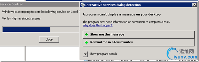

  unfortunately !!!!!!!
  this way does not work on Vista and Windows after Vista, like environment here:Windows server 2008,
  and while starting the service, SCM will launch the debugger, but crashed!
  here provide a screen snapshot for the crash dialog with message(a program can’t display a meesage on your desktop):
  if you click the “Show me the message”, the windbg will display but only for few seconds, if you click the “Remind me in a few minutes”, the windbg will never launched!

  那文档有没有针对我所碰到的问题(相信还有其他人也会碰到)给出work around呢,有的,那就是Interactive Service Detection Service,也就是之前我给出那幅crash截图,就是这所谓的Detection Service,其功效:
  The service detects these visible dialog boxes or windows and sends a notification to the user. Users may choose to:
  · Respond to the dialog box immediately by clicking a button to switch to Session 0, interact with the task dialog box, and then return to their session.
  · Be reminded again in 5 minutes. They continue to be reminded until the dialog box closes.
  但是根本不能让windbg继续调试下去,只不过提供了一个错误通知,而文档也说了,如此一来:
  This helps ensure that testers are aware of legacy services in their environment and have the opportunity to contact the vendors for updated services.
  我靠,高,实在是高,难不成还要联系windbg团队从新给我开发一个版本不成?但是你想啊,再牛逼的windbg也得有display窗口不。。。。黯然神伤了。。
