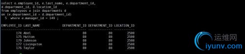

  使用AND子句或WHERE子句适用附加条件: 查询manager_id为149的
  select e.employee_id, e.last_name, e.department_id,
  d.department_id, d.location_id
  from employees e join departments d
  on (e.department_id = d.department_id)
  and e.manager_id = 149;

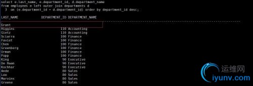

  左外连接
  select e.last_name, e.department_id, d.department_name
  from employees e left outer join departments d
  on (e.department_id = d.department_id) order by department_id desc;

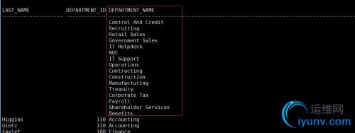

  全外连接
  select e.last_name, d.department_id, d.department_name
  from employees e full outer join departments d
  on (e.department_id = d.department_id) ;

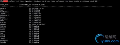

  2. HR部门需要一个可以查出所有员工的 last_name,department_id,department_name 的查询语句
  select last_name,department_id,department_name from employees join departments using(department_id);

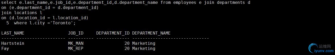

  3.  请查出所有在 Toronto工作的员工的 last_name,job_id,department_id,department_name.
  select e.last_name,e.job_id,e.department_id,d.department_name from employees e join departments d
  join locations l
  on (d.location_id = l.location_id)
  where l.city ='Toronto';
