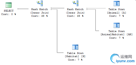

  This is the actual execution plan without the FORCE ORDER hint.  You can see that SQL Server starts at the table Animal and AnimalHabitat tables, then goes to the Habitat table.  If you look at our query above, we clearly list the tables in the order of Habitat, AnimalHabitat, then Animal.
