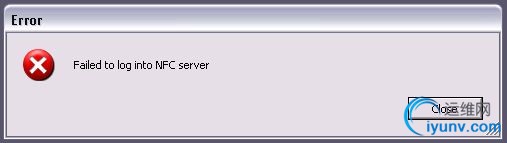

  Problem Symptom:
  Runtime Envirnment:
  Vcenter 5.5
  ESXI 5.5
  Client WIndows 7 with Wireless
  Solution Reference:
  http://www.vspecialist.co.uk/2012/10/failed-to-login-to-nfc-server-errors-in-vsphere/
  http://blog.vmote.net/?p=892
  Soultion:
  Any of the below KBs or Communities threads may be>should always be DNS! Check this first and resolve any issues before delving further into support and troubleshooting.
  While looking for causes I found these possibilities:
  •   Not enough space in the datastore
  •   Port 901/902 not open between the VI Client to the source of the file (and/or VC Server, could not find if that is also a factor)
  •   DNS configuration for the host servers
  •   As a possible solution I also found that restarting the VC Server service could help.
  My Personal Solution:
  Since i used wireless to download the data from store, then i try to connect the ESXI via vsphere client, but failed.
  Then i check DNS, it is ok, i can ping thenm via Netbios name
  The problem is why i can't login Exsi host server via vsphere client?
  then i plug the cable, it is works. i don't know why
  So the solution is:
  useing cable to connect the client computer to network and download,
