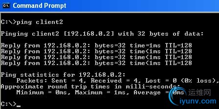

  Now go on commands prompt and ping from other client by name to test dns.

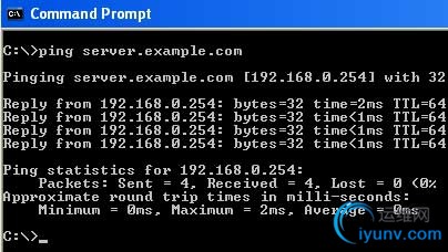

  Test also by pinging server from name

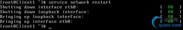

  After saving /etc/resolv.conf file restart the network service

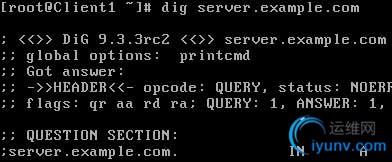

  dig server.example.com to test dns server

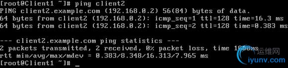

  now verify by pinging to other client from name
