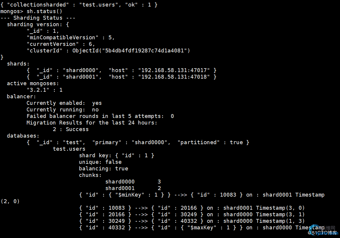

mongos> sh.shardCollection("test.users",{"id":1})
{ "collectionsharded" : "test.users", "ok" : 1 }
#执行分片,可以看到分片成功1-20165,写入到shard0001中,20166-50000写入到shard0000中
