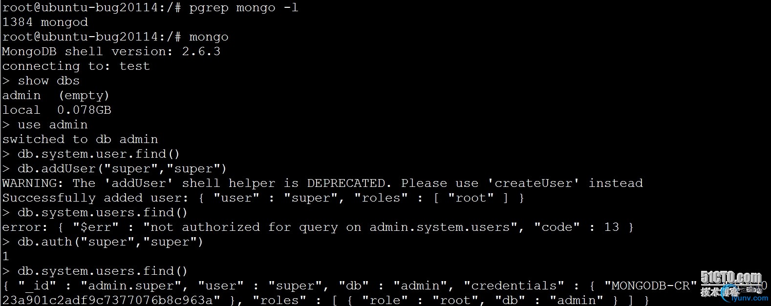

  root@ubuntu-bug20114:/# pgrep mongo -l
  1384 mongod

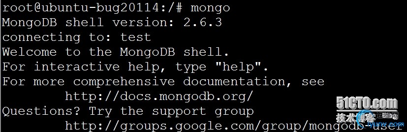

  root@ubuntu-bug20114:/# mongo
  MongoDB shell version: 2.6.3
  connecting to: test
  > show dbs
  admin  (empty)
  local  0.078GB
  > use admin
  switched to db admin
  > db.system.user.find()
  > db.addUser("super","super")
  WARNING: The 'addUser' shell helper is DEPRECATED. Please use 'createUser' instead
  Successfully added user: { "user" : "super", "roles" : [ "root" ] }
  > db.system.users.find()
  error: { "$err" : "not authorized for query on admin.system.users", "code" : 13 }
  > db.auth("super","super")
  { "_id" : "admin.super", "user" : "super", "db" : "admin", "credentials" : { "MONGODB-CR" : "9c93023a901c2adf9c7377076b8c963a" }, "roles" : [ { "role" : "root", "db" : "admin" } ] }

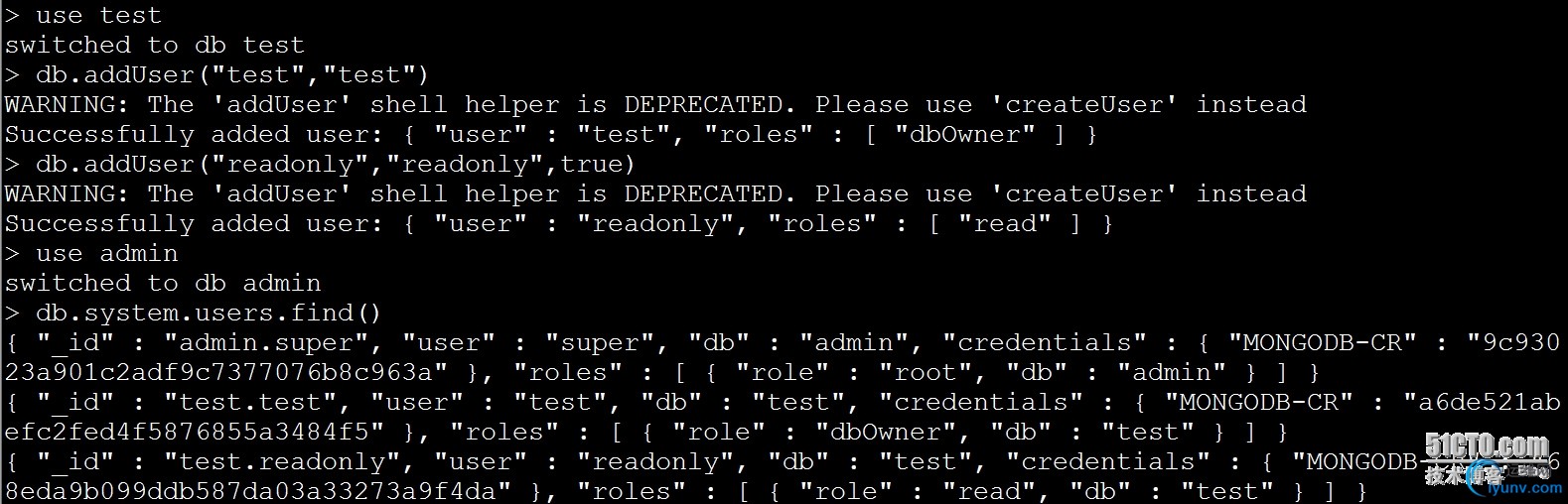

  > use test
  switched to db test
  > db.addUser("test","test")
  Successfully added user: { "user" : "test", "roles" : [ "dbOwner" ] }
  > db.addUser("readonly","readonly",true)
  Successfully added user: { "user" : "readonly", "roles" : [ "read" ] }
  > use admin
  { "_id" : "test.test", "user" : "test", "db" : "test", "credentials" : { "MONGODB-CR" : "a6de521abefc2fed4f5876855a3484f5" }, "roles" : [ { "role" : "dbOwner", "db" : "test" } ] }
  { "_id" : "test.readonly", "user" : "readonly", "db" : "test", "credentials" : { "MONGODB-CR" : "68eda9b099ddb587da03a33273a9f4da" }, "roles" : [ { "role" : "read", "db" : "test" } ] }

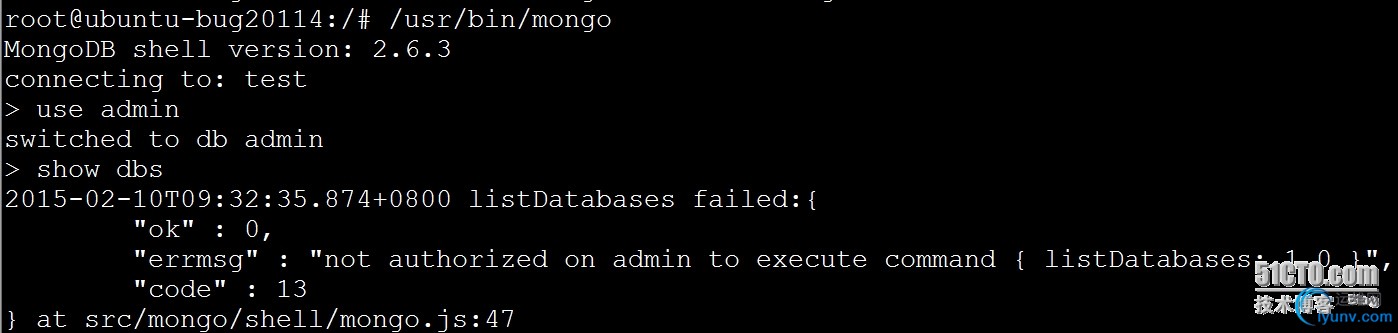

  exit退出
  重新验证用户权限
  报错,没有认证
