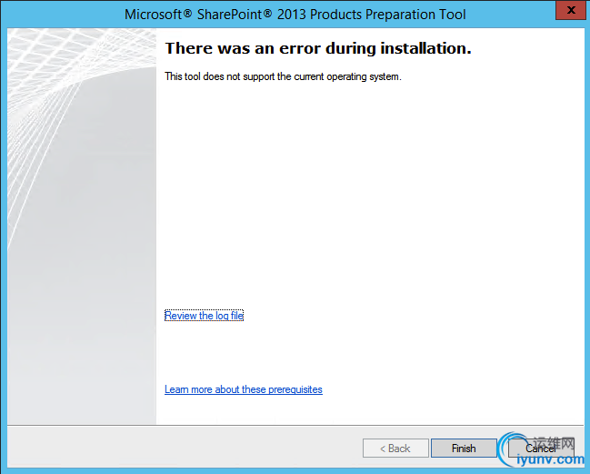

  OK, here’s the fun part.  You can easily download and install the prerequisites that SharePoint needs, but you have to do a little more than just download and run the install wizards.
  The good news is that Craig Lussier has written three scripts to both download and install the SharePoint 2013 prerequisites.  The bad news is that only the download script works on Windows Server 2012 R2 (they probably work fine on vanilla 2012), because the install scripts use Prerequisiteinstaller.exe, which throws the same “This tool does not support the current operating system” error that we saw above.  So we’ll only take advantage of the download script, and do the rest manually.

  12) Click on each file to run the installers, EXCEPT:
  • Windows6.1-KB974405-x64.msu
  • WindowsServerAppFabricSetup_x64.exe
  • AppFabric1.1-RTM-KB2671763-x64-ENU.exe
  (In fact, you can even delete Windows6.1-KB974405-x64.msu.  I couldn’t get it to run successfully on Windows 2012 R2 no matter what Google told me.  Besides, it’s for installing WIF, which you installed above in step A.8, so we won’t be using it at all.)

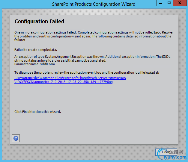

  4) Do run the SharePoint Products Configuration wizard at the end of the installation.  Just note that it will fail during configuration task 8 of 10 (Creating sampledata), with the error: “The SDDL string contains an invalid sid or a sid that cannot be translated.”:
  This is fine for now, as we will run the configuration tweaks below to fix that.  But we need the wizard to set up the initial databases and users for us to tweak first, so make sure that you do run it to failure, and click “Close” to exit the Wizard.
  B. CONFIGURATION TWEAKS
  If you go to Administrative Tools->Services, you’ll see that the AppFabric Caching Service is not running.  This is because it does not have proper permissions to a number of resources  We’ll need to set these and then start the service (as well as configure it to start automatically).

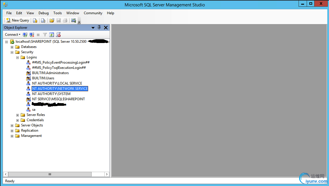

1. Set DATABASE permissions for NETWORK SERVICE
  (I don’t remember the source for the below, but something similar was posted here.)
  1) You will need SQL Server Management Studio so that you can access the database directly and set the permissions properly.  If you haven’t already installed SQL Server itself, then download and install SQL Server Management Studio Express for SQL Server Express 2008 R2 from http://www.microsoft.com/en-us/download/details.aspx?id=22985 (note that the version of SQL Express that SharePoint 2013 installs is 2008 R2, not 2012.  I know.).
  NOTE: When installing SQL Server Management Studio Express, you will likely get warnings that say “This program has compatibility issues”.  Just click on “Run the program without getting help” and continue the install.
  2) Run SQL Server Management Studio, and connect to the SharePoint database instance.  If you installed a stand-alone configuration, this server name you need to connect to is localhost\SHAREPOINT:
  3) Expand the database, and expand the “Security” folder.  You should see the “NT AUTHORITY\NETWORK SERVICE” user
  4) Right click on this NETWORK SERVICE user and select “Properties.”

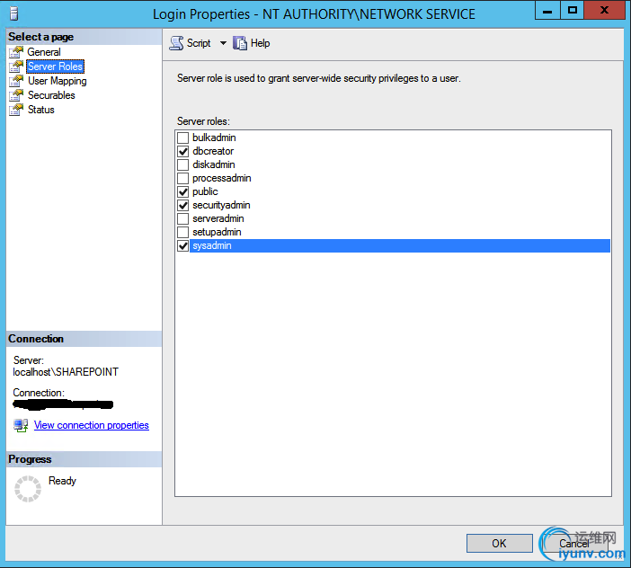

  5) Select “Server Roles” on the left, and check the “sysadmin” role on the right:
  5) Click “OK”.  You can exit SQL Server Management Studio now.

  4. Re-run the SharePoint Product Configuration Wizard.
  1) From the Windows “Start” screen, type “SharePoint 2013 Products Wizard”
  2) Click on the result that comes up.  The wizard will start running.
  3) Click “Next” to run the wizard.
  4) When the warning “The following services may have to be started or reset during the configuration:” pops up, just click on the “Yes” button.
  5) You’ll notice that the wizard begins at task 4, but will successfully pass through task 8 to the last task (task 10), and complete successfully.
