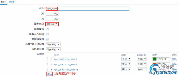

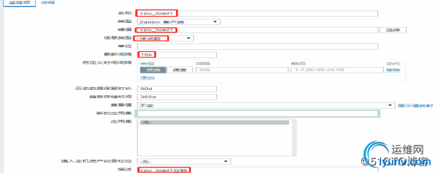

  监控CPU负载
  Agent端:
  [root@zabbix-agent1 ~]# vim /etc/zabbix/zabbix_agentd.conf
  UserParameter=cpu_load1,/usr/bin/w|awk 'NR==1 {print $10}'|awk -F, '{print $1}'
  UserParameter=cpu_load5,/usr/bin/w|awk 'NR==1 {print $11}'|awk -F, '{print $1}'
  UserParameter=cpu_load15,/usr/bin/w|awk 'NR==1 {print $12}'
  Server端:
  [root@zabbix-server ~]# zabbix_get -s 10.0.0.101 -k cpu_load1
  0.00
  [root@zabbix-server ~]# zabbix_get -s 10.0.0.101 -k cpu_load5
  0.01
  [root@zabbix-server ~]# zabbix_get -s 10.0.0.101 -k cpu_load15
  0.05
  Step1(配置-->模板-->创建模板):
  Step2(创建克隆监控项):
  Step3(创建克隆触发器):
  Step4(创建图形):

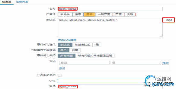

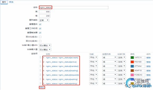

      Server端检测:
      [root@zabbix-server ~]# zabbix_get -s 10.0.0.101 -k nginx_status[accepts]
      177
      Step2(添加克隆监控项):
      Step3(添加触发器):
      Add部分
      Step4(添加图形):
      Step5(为主机添加模板):

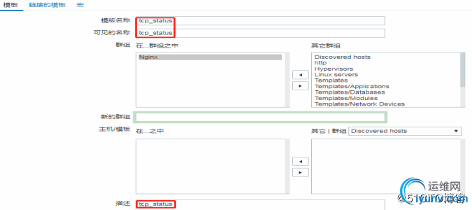

      Server端
      [root@zabbix-server ~]# zabbix_get -s 10.0.0.101 -k tcp_status[ESTAB] ##出现这种错误到客户端删掉/opt/ss.txt文件
      /etc/zabbix/scripts/tcp_status.sh: line 18: /tmp/ss.txt: Permission denied
      [root@zabbix-server ~]# zabbix_get -s 10.0.0.101 -k tcp_status[ESTAB]  ##检验键值
      Step1(创建模板):
      Step2(创建克隆监控项):
      Step3(创建图形):
      Step4(关联主机):

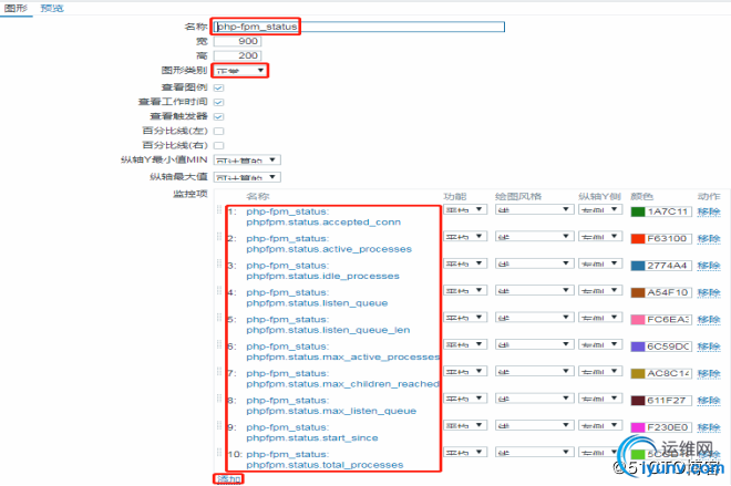

      Server端:
      [root@zabbix-server zabbix]# zabbix_get -s 10.0.0.101 -k phpfpm_status[accepted_conn]
      20
      Step1(创建模板):
      Step2(关联主机):
