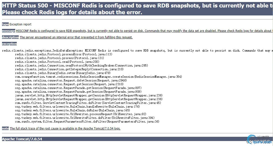

  1、问题描述:
  用浏览器打开网站 https://www.test.org 提示:MISCONF Redis is configured to save RDB snapshots, but is currently not able to persist on disk. Commands that may modify the data set are disabled. Please check Redis logs for details about the error.,具体报错如下:
