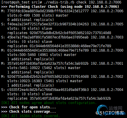

  C、为空节点分配slot
#./redis-trib.rb reshard 192.168.0.2:7006
//执行结果显示,并按提示输入:
How many slots do you want to move (from 1 to 16384)? 500   //被删除master的slot数量
What is the receiving node>
Please enter all the source node>  Type 'all' to use all the nodes as source nodes for the hash slots.
  Type 'done' once you entered all the source nodes>
Source node #1:01c944eb66564d41e355388dc468ee79e71fe789   //被删除slot的7000主节点
Source node #2:done
Do you want to proceed with the proposed reshard plan (yes/no)? yes //确认重新分
  注意:source node 要用 ‘done’,如果用’all’则会将其他每个master节点的slot 分给接收slot的节点。最好别用‘all’, 会造成slot 分割碎片。
  执行结果显示:
  从上图可以知道,新的主节点已经添加并分配好slots,slots值的范围为500.
  D、验证使用该节点
  从上图知道,新节点已经添加并配置成功,并且使用正常无问题。
