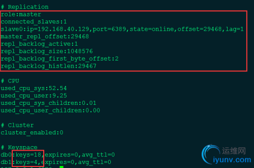

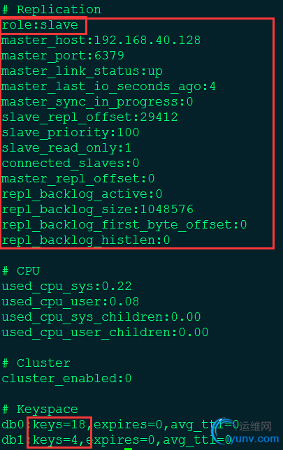

  4. 查看Replication信息

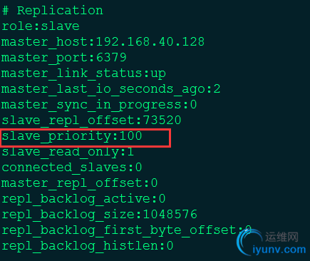

  Master:
  Slave:

  # 当master不可用,Sentinel会根据slave的优先级选举一个master。最低的优先级的slave,当选master。而配置成0,永远不会被选举。
  # The slave priority is an integer number published by Redis in the INFO output.
  # It is used by Redis Sentinel in order to select a slave to promote into a
  # master if the master is no longer working correctly.
  #slave优先级是由Redis在INFO输出中发布的整数。 它由Redis Sentinel使用,以便选择slave,如果master不再正常工作,则升级为主设备。
  # A slave with a low priority number is considered better for promotion, so
  # for instance if there are three slaves with priority 10, 100, 25 Sentinel will
  # pick the one with priority 10, that is the lowest.
  #具有低优先级编号的slave被认为更好地用于提升,因此例如如果存在具有优先级10,100,25的三个从设备,则哨兵将选择具有优先级10,即最低的那个。
  # However a special priority of 0 marks the slave as not able to perform the
  # role of master, so a slave with priority of 0 will never be selected by
  # Redis Sentinel for promotion.
  #然而,0的特殊优先级标志着slave不能执行主设备的角色,因此优先级为0的从设备将不会被Redis Sentinel选择用于升级。
  # By default the priority is 100.
  slave-priority 100
