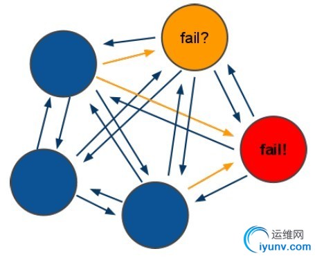

  Redis-cluster
  前面redis集群搭建测试完了,接着开始调试:
  1. Redis-cluster容错,master宕机以后slave选举升级为master;
  7000master没出故障之前:
  7003slave->7000 master
  127.0.0.1:7001>cluster nodes
  c500c301825ceeed98b7bb3ef4f48c52d42fe72d127.0.0.1:7003 slave b62852c2ced6ba78e208b5c1ebf391e14388880c 0 1478763693463 10 connected
  6d04c7a1efa63ca773114444591d04f6d340b07d127.0.0.1:7001 myself,master - 0 0 2 connected 5461-10922
  b62852c2ced6ba78e208b5c1ebf391e14388880c 127.0.0.1:7000 master - 01478763693968 10 connected 0-5460
  79d8a5dc7e6140540c03fe0664df6a8150d0888f127.0.0.1:7004 slave 6d04c7a1efa63ca773114444591d04f6d340b07d 0 1478763692453 5connected
  642a60187eea628a3be7fa1bb419e898c6b4f36a127.0.0.1:7002 master - 0 1478763692453 3 connected 10923-16383
  bf2e5104f98e46132a34dd7b25655e41455757b5127.0.0.1:7005 slave 642a60187eea628a3be7fa1bb419e898c6b4f36a 0 1478763692453 6connected
  故意宕掉7000端口
  日志:
  32138:M10 Nov 15:39:24.781 * FAIL message received from6d04c7a1efa63ca773114444591d04f6d340b07d about79d8a5dc7e6140540c03fe0664df6a8150d0888f
  32138:M10 Nov 15:39:24.782 * FAIL message received from6d04c7a1efa63ca773114444591d04f6d340b07d aboutc500c301825ceeed98b7bb3ef4f48c52d42fe72d
  32138:M10 Nov 15:39:24.867 * Marking node bf2e5104f98e46132a34dd7b25655e41455757b5 asfailing (quorum reached).
  32138:M 10Nov 15:39:27.532 * Clear FAIL state for nodec500c301825ceeed98b7bb3ef4f48c52d42fe72d: slave is reachable again.
  32138:M10 Nov 15:39:28.566 * Slave 127.0.0.1:7003 asks for synchronization
  32138:M10 Nov 15:39:28.566 * Full resync requested by slave 127.0.0.1:7003
  32138:M10 Nov 15:39:28.566 * Starting BGSAVE for SYNC with target: disk
  32138:M10 Nov 15:39:28.567 * Background saving started by pid 32154
  32154:C10 Nov 15:39:28.609 * DB saved on disk
  32154:C10 Nov 15:39:28.610 * RDB: 4 MB of memory used by copy-on-write
  32138:M10 Nov 15:39:28.666 * Background saving terminated with success
  32138:M10 Nov 15:39:28.667 * Synchronization with slave 127.0.0.1:7003 succeeded
  32138:M10 Nov 15:39:31.612 * Clear FAIL state for node 79d8a5dc7e6140540c03fe0664df6a8150d0888f:slave is reachable again.
  32138:M10 Nov 15:39:36.121 * Clear FAIL state for nodebf2e5104f98e46132a34dd7b25655e41455757b5: slave is reachable again.
  32138:signal-handler(1478764594) Received SIGTERM scheduling shutdown...
  c500c301825ceeed98b7bb3ef4f48c52d42fe72d 127.0.0.1:7003 master - 01478764604059 11 connected 0-5460
  b62852c2ced6ba78e208b5c1ebf391e14388880c 127.0.0.1:7000 master,fail- 1478764594145 1478764593839 10 disconnected
  79d8a5dc7e6140540c03fe0664df6a8150d0888f127.0.0.1:7004 slave 6d04c7a1efa63ca773114444591d04f6d340b07d 0 1478764605077 5connected
  642a60187eea628a3be7fa1bb419e898c6b4f36a127.0.0.1:7002 master - 0 1478764604567 3 connected 10923-16383
  bf2e5104f98e46132a34dd7b25655e41455757b5127.0.0.1:7005 slave 642a60187eea628a3be7fa1bb419e898c6b4f36a 0 1478764603546 6connected
