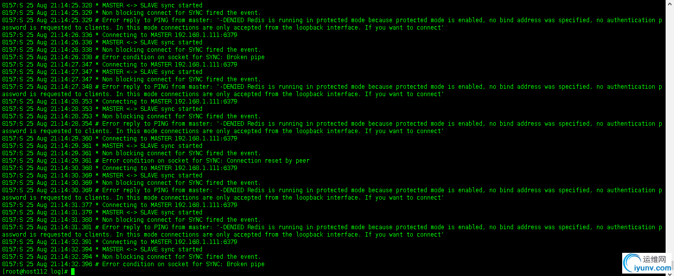

  遇到的一个问题:
  在虚拟机不同主机(192.168.1.111和192.168.1.112)之间配置redis复制,slave端已经加入“slaveof DSC0000.png 192.168.1.111 6378”,并且在master注释掉bind,但无法实现复制,在slave上显示:
redis-cli -p 6379 info
  查看slave端的日志:
tail -n200 /var/log/redis_6379.log
  在112上运行如下命令:
[root@host112 log]# telnet 192.168.1.111 6379  有如下结果:
  Trying 192.168.1.111...
  Connected to 192.168.1.111.
  Escape character is '^]'.
  -DENIED Redis is running in protected mode because protected mode is enabled, no bind address was specified, no authentication password is requested to clients. In this mode connections are only accepted from the loopback interface. If you want to connect from external computers to Redis you may adopt one of the following solutions: 1) Just disable protected mode sending the command 'CONFIG SET protected-mode no' from the loopback interface by connecting to Redis from the same host the server is running, however MAKE SURE Redis is not publicly accessible from internet if you do so. Use CONFIG REWRITE to make this change permanent. 2)>  Connection closed by foreign host.
  参考http://arui.me/index.php/archives/151/
  将master的这一项protected-mode由yes改为no,就可以正常实现复制了。该参数是3.2版本之后加入的新特性。
