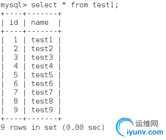

  mysql
  mysql> use test;
  mysql> select * from test;

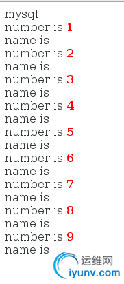

  检测:
  网页访问http://172.25.85.2   ##已经完成redis对mysql的缓存

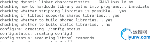

  tar zxf gearman-1.1.2.tgz
  cd gearman-1.1.2
  phpize
  ./configure
  cd ..
  yum install -y libgearman-devel-1.1.8-2.el6.x86_64.rpm
  libevent-devel-1.4.13-4.el6.x86_64.rpm
  libevent-doc-1.4.13-4.el6.noarch.rpm
  libevent-headers-1.4.13-4.el6.noarch.rpm
  cd gearman-1.1.2
  ./configure

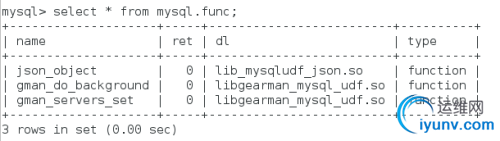

  #注册UDF函数
  mysql
  mysql> create function json_object returns string soname 'lib_mysqludf_json.so';
  mysql> select * from mysql.func;
  mysql> quit

  #注册UDF函数
  mysql> create function gman_do_background returns string soname 'libgearman_mysql_udf.so';
  mysql> create function gman_servers_set returns string soname 'libgearman_mysql_udf.so';
  #查看函数
  mysql> quit
