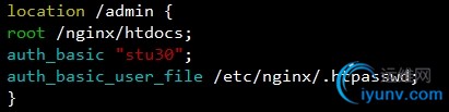

  基于用户的访问控制
[root@localhost~]# htpasswd -c -m /etc/nginx/.htpasswd stu30
New password:
Re-type new password:
Adding password for user stu30
[root@localhost ~]# mkdir/nginx/htdocs/admin -pv
mkdir: created directory `/nginx'
mkdir: created directory `/nginx/htdocs'
mkdir: created directory`/nginx/htdocs/admin'
[root@localhost ~]# !ser
service nginx restart
nginx: the configuration file/etc/nginx/nginx.conf syntax is ok
nginx: configuration file/etc/nginx/nginx.conf test is successful
Stopping nginx:                                           [  OK  ]
Starting nginx:                                             [ OK  ]
  访问结果:需要输入密码,才能访问
