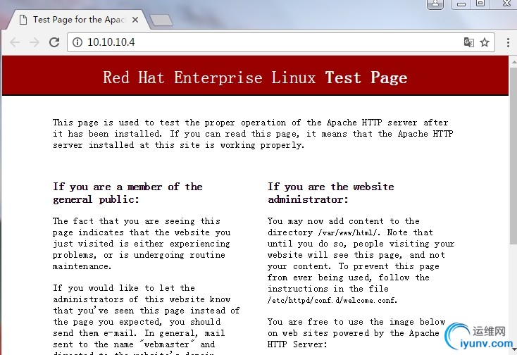

[root@wlm ~]# httpd -t     # 语法检测
httpd: apr_sockaddr_info_get() failed for wlm # #此错误忽略,是因为没有设置ServerName,后面会讲
httpd: Could not reliably determine the server's fully qualified domain name, using 127.0.0.1 for ServerName
Syntax OK
[root@wlm yum.repos.d]# /etc/init.d/httpd restart    # 重启进程
Stopping httpd:                                            [FAILED]
Starting httpd: httpd: apr_sockaddr_info_get() failed for wlm    #此错误忽略,是因为没有设置ServerName,后面会讲
                                                           [  OK  ]  测试:从浏览器访问,默认是访问80端口,出现的是默认测试页面

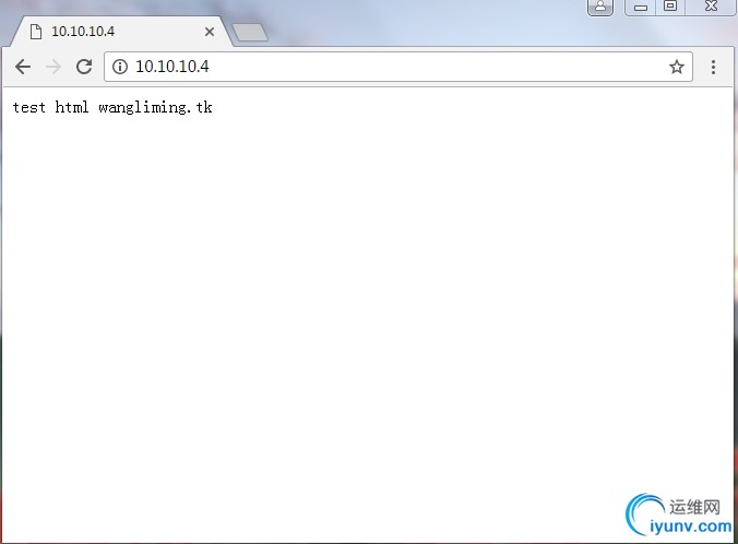

[root@wlm ~]# vim /etc/httpd/conf/httpd.conf
    DocumentRoot "/var/www/html" # 默认为/var/www/html目录
    # 改为/web/目录下,首先得创建web目录,然后书写一个index.html文件
    DocumentRoot "/web"
    # Note that from this point forward you must specifically allow
    # particular features to be enabled - so if something's not working as
    # you might expect, make sure that you have specifically enabled it
    # below.
    # This should be changed to whatever you set DocumentRoot to.
        # 这里一并改掉
# 保存退出
# 重新加载httpd服务器
Syntax OK
[root@wlm ~]# /etc/init.d/httpd reload
Reloading httpd:  # 测试(确保selinux和iptables是关闭的,且/web目录下有index.html文件)

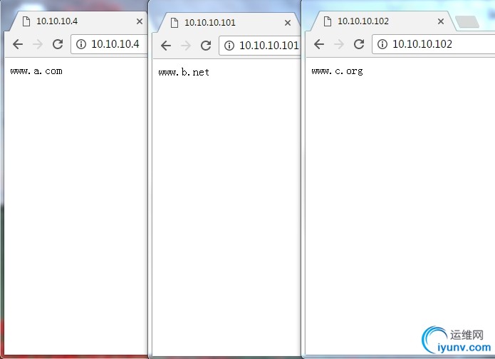

  基于IP的虚拟主机示例:
  (1)添加多个IP
[root@wlm web]# ifconfig eth0:0 10.10.10.101 up
[root@wlm web]# ifconfig eth0:1 10.10.10.102 up    # 在一块网卡上再添加两个IP  (2)要使用虚拟主机,得先禁用'main'主机;
禁用方法:注释中心主机的DocumentRoot指令即可;
#DocumentRoot "/web"    # 加#禁用  (3)配置
        ServerName www.a.com
        DocumentRoot "/web/a.com"
        ServerName www.b.net
        DocumentRoot "/web/b.net"
        ServerName www.c.org
        DocumentRoot "/web/c.org"
  (4)创建/www/下的文件
[root@wlm web]# mkdir /web/
[root@wlm web]# echo "www.a.com" > /web/www.a.com/index.html
[root@wlm web]# echo "www.b.net" > /web/
[root@wlm web]# echo "www.c.org" > /web/www.c.org/index.html  (5)语法检测,重新转载
[root@wlm web]# httpd -t
Syntax OK
[root@wlm web]# /etc/init.d/httpd restart
Stopping httpd:                                            [  OK  ]
Starting httpd:  (6)测试
  通过不通地址从浏览器访问

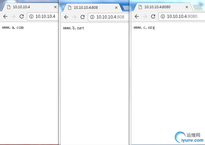

  基于端口的虚拟主机:
  (1)修改配置如下
Listen 80    # 监听多个端口
Listen 808
Listen 8080
# 不通的端口对应不通的主页
        DocumentRoot "/web/www.a.com"
        DocumentRoot "/web/www.b.net"
        DocumentRoot "/web/www.c.org"
  (2)语法检测,重新装载
Syntax OK
Starting httpd:  (3)测试

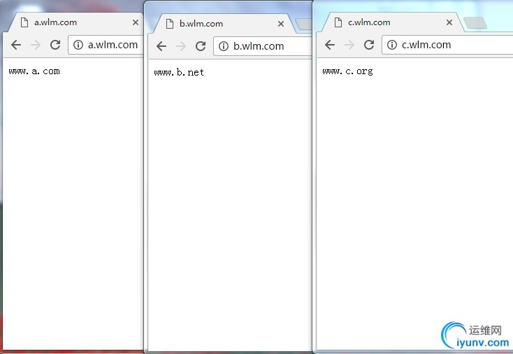

  基于FQDN(域名)的虚拟主机:
  (1)配置一个DNS服务器正在向区域文件里添加3个域名解析到该web主机(关于DNS配置见我另一篇文档http://afterdawn.blog.51cto.com/7503144/1420116)或是在hosts文件里面直接添加域名和映射的IP
  如果没有现成的DNS服务器,这里建议直接写hosts文件
# DNS服务器里在向区域文件里的配置
$TTL 3600
$ORIGIN wlm.com.
@       IN      SOA     ns1.wlm.com.   dnsadmin.wlm.com. (
        2014100101
        1H
        10M
        3D
        1D )
        IN      NS      ns1
        IN      NS      ns2
        IN      MX   10 mx1
        IN      MX   20 mx2
ns2     IN      A       10.10.10.10
ns1     IN      A       10.10.10.3
a       IN      A       10.10.10.4
b       IN      A       10.10.10.4
c       IN      A       10.10.10.4
# 如果是hosts文件
直接写域名和对应的IP即可  (2)配置
NameVirtualHost 10.10.10.4:80    #声明10.10.10.4:80为该虚拟主机的IP端口
        ServerName a.wlm.com
        ServerName b.wlm.com
        ServerName c.wlm.com
  (3)语法检测,重载
Syntax OK
[root@wlm web]# /etc/init.d/httpd reload
Reloading httpd:  (4)测试,用不通域名访问
