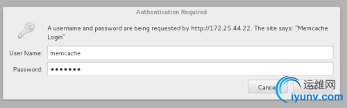

  访问172.25.44.22/example.php,如图:
  访问172.25.44.22/memcache.php,如图:

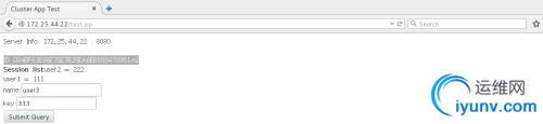

访问172.25.44.22/test.jsp
  如图:

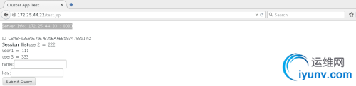

当停掉server2上的tomcat,
[root@server2 ~]# /usr/local/lnmp/tomcat/bin/shutdown.sh
Using CATALINA_BASE:   /usr/local/lnmp/tomcat
Using CATALINA_HOME:   /usr/local/lnmp/tomcat
Using CATALINA_TMPDIR: /usr/local/lnmp/tomcat/temp
Using JRE_HOME:        /usr/local/java
Using CLASSPATH:       /usr/local/lnmp/tomcat/bin/bootstrap.jar:/usr/local/lnmp/tomcat/bin/tomcat-juli.jar
访问172.25.44.22/test.jsp,server3将会接管
  如图:
