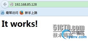

  至此:用两种方式都可以启动
  # lsof -i:80 # httpd没有启动
  # apachectl start
  # lsof -i:80
  COMMAND   PID   USER   FD   TYPE DEVICE SIZE/OFF NODE NAME
  httpd   62448   root    4u  IPv6 181067      0t0  TCP *:http (LISTEN)
  httpd   62449 daemon    4u  IPv6 181067      0t0  TCP *:http (LISTEN)
  httpd   62450 daemon    4u  IPv6 181067      0t0  TCP *:http (LISTEN)
  httpd   62451 daemon    4u  IPv6 181067      0t0  TCP *:http (LISTEN)
  # apachectl stop
  # lsof -i:80
  # /etc/init.d/httpd start
  Starting httpd:                                            [  OK  ]
  # lsof -i:80
  httpd   62544   root    4u  IPv6 181205      0t0  TCP *:http (LISTEN)
  httpd   62546 daemon    4u  IPv6 181205      0t0  TCP *:http (LISTEN)
  httpd   62547 daemon    4u  IPv6 181205      0t0  TCP *:http (LISTEN)
  httpd   62548 daemon    4u  IPv6 181205      0t0  TCP *:http (LISTEN)
  # /etc/init.d/httpd stop
  Stopping httpd:                                            [  OK  ]
  # lsof -i:80
