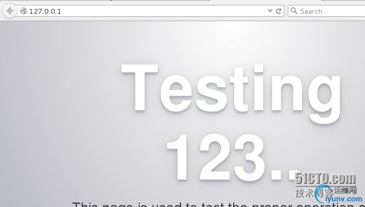

# make install  正常完成,看看正常不:
