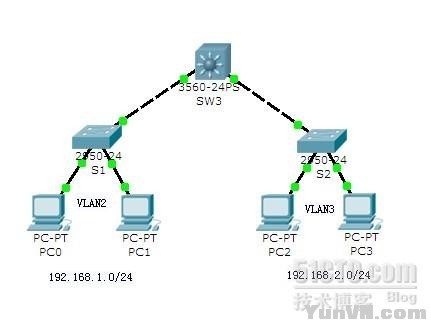

先看拓扑:
一般来说配置不成什么问题,一定记得开启三层的ip routing
S1配置:
Switch#show run
Building configuration...
Current configuration : 1066 bytes
version 12.1
no service timestamps log datetime msec
no service timestamps debug datetime msec
no service password-encryption
hostname Switch
no ip domain-lookup
spanning-tree mode pvst
interface FastEthernet0/1
switchport access vlan 2
interface FastEthernet0/2
interface FastEthernet0/3
interface FastEthernet0/4
interface FastEthernet0/5
interface FastEthernet0/6
interface FastEthernet0/7
interface FastEthernet0/8
interface FastEthernet0/9
interface FastEthernet0/10
interface FastEthernet0/11
interface FastEthernet0/12
interface FastEthernet0/13
interface FastEthernet0/14
interface FastEthernet0/15
interface FastEthernet0/16
interface FastEthernet0/17
interface FastEthernet0/18
interface FastEthernet0/19
interface FastEthernet0/20
interface FastEthernet0/21
interface FastEthernet0/22
interface FastEthernet0/23
interface FastEthernet0/24
switchport mode trunk
interface Vlan1
no ip address
shutdown
line con 0
line vty 0 4
login
line vty 5 15
login
end
S2配置:
Switch#show run
version 12.1
hostname Switch
no ip domain-lookup
switchport access vlan 3
interface Vlan1
no ip address
shutdown
line con 0
line vty 0 4
login
line vty 5 15
login
end
  S3配置:
Switch#show run
Current configuration : 1192 bytes
version 12.2
hostname Switch
ip routing
interface GigabitEthernet0/1
interface GigabitEthernet0/2
interface Vlan1
no ip address
shutdown
interface Vlan2
ip address 192.168.1.1 255.255.255.0
interface Vlan3
ip address 192.168.2.1 255.255.255.0
ip classless
line con 0
line vty 0 4
login
end
注 :下面附PKZ文件下载
