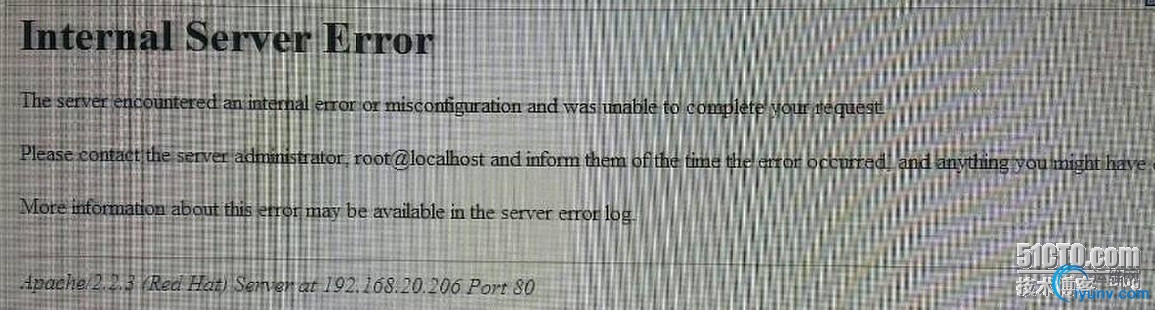

  直接登录tomcat,查询报表出现如下报错
  主要错误信息:
  The server encountered an internal error or misconfiguration and was unable to complete your request.
  Please contact the server administrator, root@localhost and inform them of  the time the error occurred and anything you might have ...
  More information about this error may be available in the server error log.
