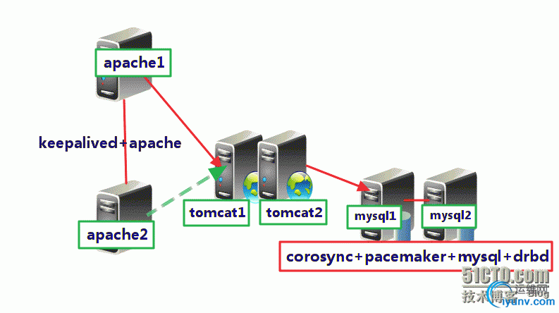

  拓扑图:
  拓扑图的规划:
IP 地址
所需安装软件
apache1
Eth0:172.16.22.1
VIP1:172.16.22.100
Keepalived+apache+tomcat-connectors
apache2
Eth0:172.16.22.2
VIP1:172.16.22.100
tomcat1
Eth0:172.16.22.3
Jdk+tomcat+mysql-connector-java
tomcat2
Eth0:172.16.22.4
mysql1
Eth0:172.16.22.5
VIP2:172.16.22.200
Corosync+pacemaker+Mysql+drbd
mysql2
Eth0:172.16.22.6
VIP2:172.16.22.200

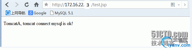

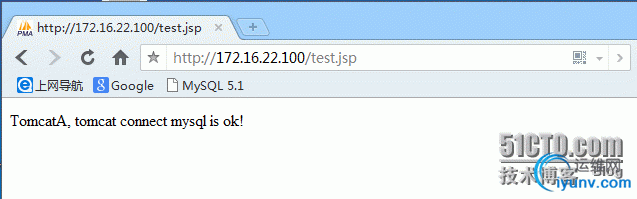

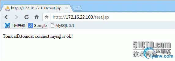

  三、tomcat服务器测试与mysql的连接
  tomcat1的配置:
[root@jie3 ~]# cd /usr/local/tomcat/conf/
[root@jie3 conf]# vim server.xml
#=================tomcat,server.xml的部分相关配置===================
#监听的端口改为了80
#defaultHost把默认的localhost改为了新建的主机名
#新建了一个虚拟主机,站点和网页文件存放在/tomcat/test目录下
================================部分配置文件==========================
#=========利用catalina重启tomcat===========================
[root@jie3 conf]# catalina.sh stop
Using CATALINA_BASE:   /usr/local/tomcat
Using CATALINA_HOME:   /usr/local/tomcat
Using CATALINA_TMPDIR: /usr/local/tomcat/temp
Using JRE_HOME:        /usr/java/latest
Using CLASSPATH:       /usr/local/tomcat/bin/bootstrap.jar:/usr/local/tomcat/bin/tomcat-juli.jar
[root@jie3 conf]# catalina.sh start
#==============创建网页根目录和测试连接数据库的网页文件===============
#===============博主只是测试了tomcat1上的,各位朋友也可以测试tomcat2上
[root@jie3 conf]#mkdir -pv /tomcat/test
[root@jie3 conf]# cd /tomcat/test/
[root@jie3 test]# vim test.jsp
#==============在mysql上授权能访问数据库的网段==============
[root@jie4 ~]# mysql
mysql> grant all on *.* to 'jie'@'172.16.%.%' identified by 'jie123';
mysql> flush privileges;  测试新建的test.jsp测试文件是否可以mysql的连接
  测试tomcat连接数据库is ok!

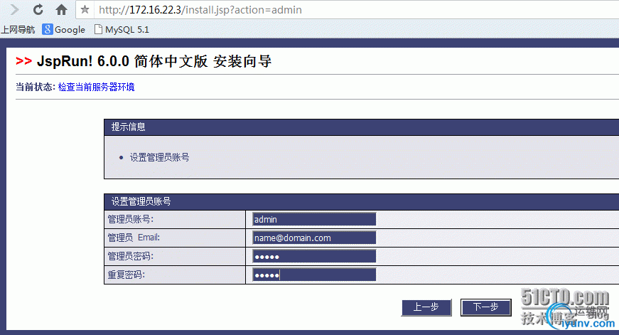

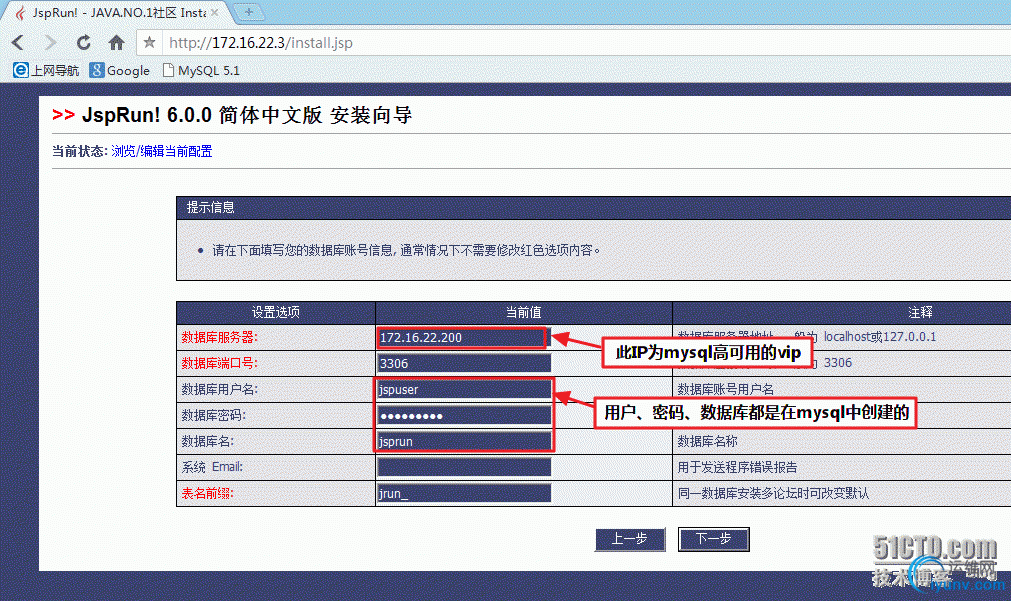

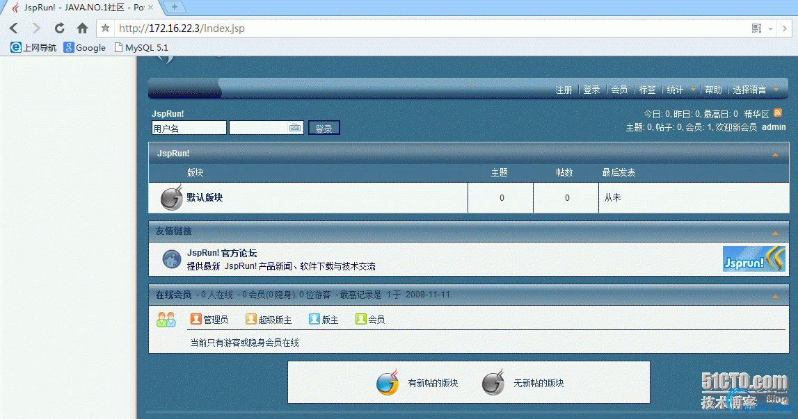

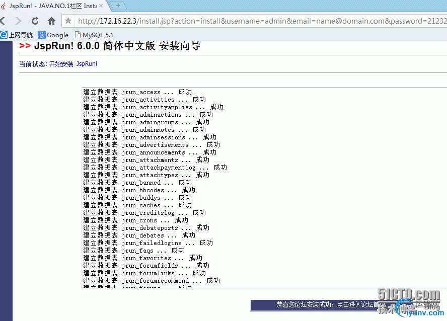

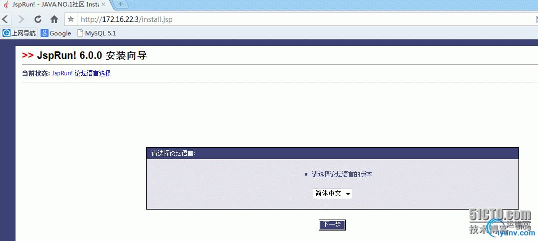

  在tomcat安装Jsprun论坛
#=================解压论坛,把论坛的文件存放到网页存放路径中=============
[root@jie3 ~]# unzip JspRun\!_6.0.0_GBK.zip
[root@jie3 ~]#mkdir  -pv /tomcat/bbs
[root@jie3 ~]#cp -rp upload/* /tomcat/bbs/
#之前已经把监听的端口改为了80
#defaultHost改为新建的论坛的虚拟主机名
#再新建了一个虚拟主机,站点和网页文件存放在/tomcat/bbs目录下
#===默认的虚拟主机还有www.test.com的虚拟主机的配置文件没给予显示
#==================在数据库上面创建,Jsprun论坛的数据库=============
mysql> create database jsprun;
Query OK, 1 row affected (0.03 sec)
mysql> grant all on jsprun.* to 'jspuser'@'172.16.%.%' identified by 'jspmypass';
Query OK, 0 rows affected (0.00 sec)  用浏览器安装Jsprun论坛
DSC0006.png 论坛已经安装成功

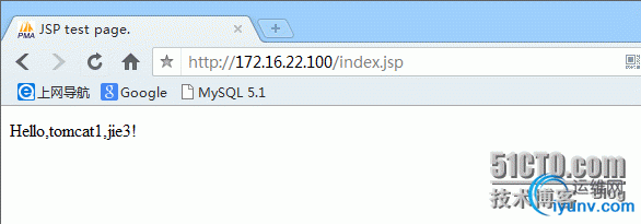

  博主只测试了tomcat1的反向代理

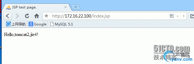

  2)mod_proxy_ajp
  apache1&apache2的配置:
  只需小小修改apache的配置文件中
[root@jie1 ~]# vim /usr/local/apache/conf/httpd.conf
#==========开启相应的模块,然后添加以下参数============================
LoadModule proxy_module modules/mod_proxy.so
LoadModule proxy_connect_module modules/mod_proxy_connect.so
LoadModule proxy_http_module modules/mod_proxy_http.so
LoadModule proxy_ajp_module modules/mod_proxy_ajp.so
ProxyVia On
ProxyRequests Off
ProxyPreserveHost On
Order deny,allow
Allow from all
ProxyPass / ajp://172.16.22.4:8009/
ProxyPa***everse / ajp://172.16.22.4:8009/
[root@jie1 ~]# httpd -t
Syntax OK
[root@jie1 ~]# service httpd reload
Reloading httpd:                                           [  OK  ]
[root@jie1 ~]#scp  /usr/local/apache/conf/httpd.conf 172.16.22.2:/ /usr/local/apache/conf/    #把配置文件copy到apache2上  tomcat1&tomcat2不需要修改
  博主只测试了tomcat2的反向代理

  测试mod_jk模式为tomcat1反向代理
  自此apache三种方式实现反向代理已经ok了

  测试mod_proxy的负载均衡

  测试mod_proxy_ajp模块的负载均衡

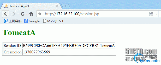

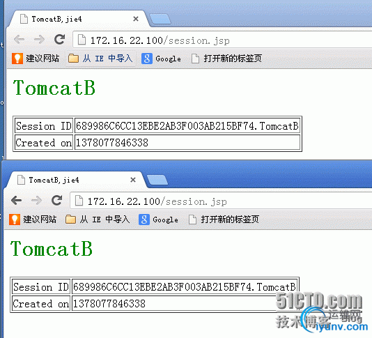

#==================可以把修改的这些文件复制到apache2上=================  tomcat1&tomcat2上的配置文件不必修改,在新建一个测试页
[root@jie3 test]# vim session.jsp
#=======================session的测试页面==============================
TomcatA
TomcatA
Session ID
Created on
  测试mod_jk模块的负载均衡
  补充:
  在apache1&apache2修改配置文件的这个参数
  [root@jie1 extra]# vim /usr/local/apache/conf/extra/workers.properties
  worker.jie.sticky_session = 0 #实现将用户session与某worker绑定
  此参数设置以后,来着同一个IP的访问一段时间内始终代理给后端的同一个tomcat上
