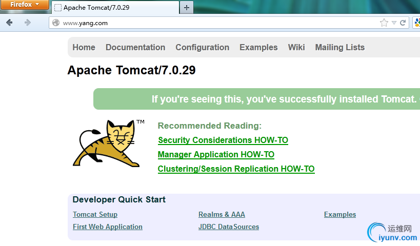

  6:测试

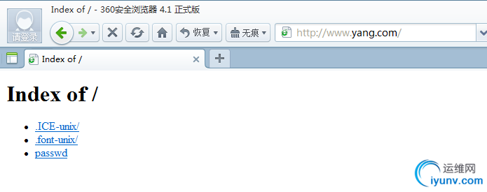

  4:配置虚拟主机,jkmount_yang.conf文件指定了客户端http请求的走向,test目录下的请求交给apache处理
  •     ServerName   www.yang.com
  •     DocumentRoot /tmp
  •     Include  conf/extra/jkmount_yang.conf
  •      Options +indexes
  •      Order allow,deny
  •      Allow from all
  •      Require all granted

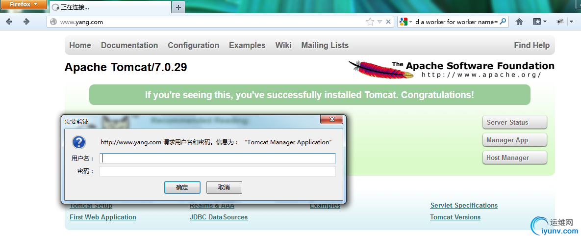

  7:测试
  [root@db1 ~]# tail -f  /usr/local/apache/logs/mod_jk.log
[Thu Aug 16 16:45:23 2012]yang www.yang.com 0.017531
[Thu Aug 16 16:45:23 2012]yang www.yang.com 0.003080
[Thu Aug 16 16:45:23 2012]yang www.yang.com 0.001009
[Thu Aug 16 16:45:23 2012]yang www.yang.com 0.001876
