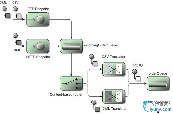

  Rider Auto Parts>
  Figure 2: This shows the solution to Rider Auto Parts integration problem using notation from the Enterprise Integration Patterns book.
  So we have several patterns in use here.
  1. There are two Message Endpoints; one for FTP connectivity and another for HTTP.
  2. Messages from these endpoints are fed into the incomingOrderQueue Message Channel
  3. The messages are consumed from the incomingOrderQueue and routed by a Content-Based Router to one of two Message Translators. As the EIP name implies, the routing destination depends on the content of the message. In this case we need to route based on whether the content is a CSV or XML file.
  4. Both Message Translators convert the message content into a POJO, which is fed into the orderQueue Message Channel.
  The whole section that uses a Content-Based Router and several Message Translators is referred to as a Normalizer. This composite pattern has a unique graphic to depict it but was left out here in favor of its sub-patterns to make things clearer.
