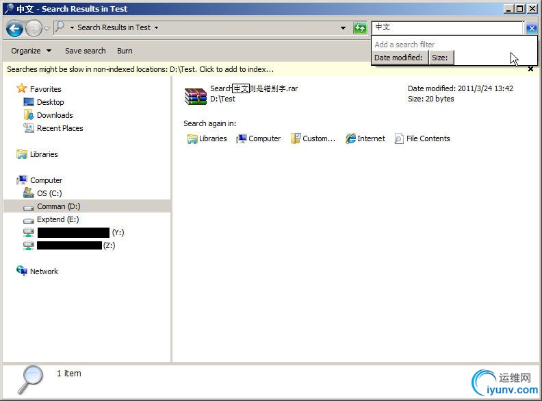

  See the comparation of adding "*" or not, I don't know why the file not matched appears here, may be there is something wrong.
  (看看加不加星花的对比,下面的中文搜索不知道怎么回事另外一个不匹配的文件也出来了,呵呵,看来是有bug啊!)
  The correct result:
  (但上面不是我们要的结果,必须加*才能搜到我们想要的:)
