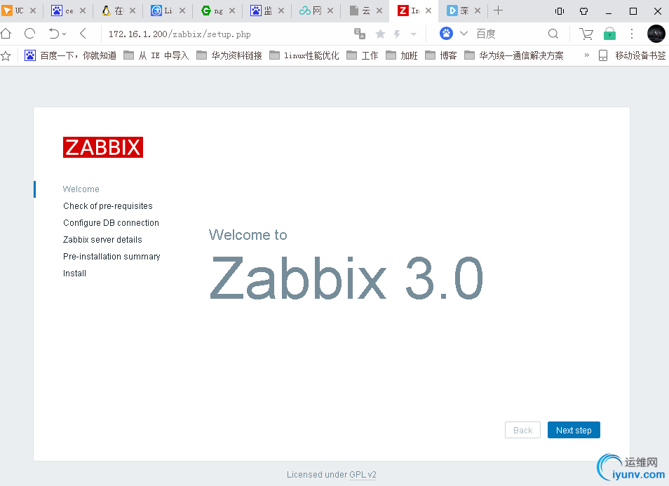

浏览器查看界面
界面配置信息
Welcome Check of pre-requisites Configure DB connection Zabbix server details Pre-installation summary Install Pre-installation summary
Please check configuration parameters. If all is correct, press "Next step" button, or "Back" button to change configuration parameters.
Database typeMySQL Database server172.16.1.200 Database portdefault Database namezabbix Database userzabbix Database password******
Zabbix serverlocalhost Zabbix server port10051 Zabbix server namezabbix-server
