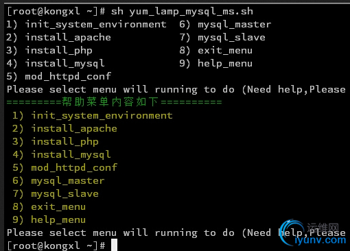

shell-scripts通过yum搭建LAMP和mysql主从

#!/bin/bash
#select menu yum install lamp and mysql master_slave
#by colink in 2015-04-28,05-13
#version v.c.m.0.3
BACKUP_DIR="/data/backup/`date +%Y%m%d`/"

#功能选择菜单
menu=(
        init_system_environment
        install_apache
        install_php
        install_mysql
        mod_httpd_conf
        mysql_master
        mysql_slave
        exit_menu
        help_menu
#因为习惯性的把help放在最后,所以这里用${#menu[@]}
PS3="Please select menu will running to do (Need help,Please input: ${#menu[@]} ): "
select i in ${menu[@]}
do
        case $i in
        ${menu[0]}) ${menu[0]} ;;
        ${menu[1]}) ${menu[1]} ;;
        ${menu[2]}) ${menu[2]} ;;
        ${menu[3]}) ${menu[3]} ;;
        ${menu[4]}) ${menu[4]} ;;
        ${menu[5]}) ${menu[5]} ;;
        ${menu[6]}) ${menu[6]} ;;
        ${menu[7]}) exit ;;
        ${menu[8]})
                echo -e "\033[32m=========帮助菜单内容如下==========\033[0m"
                for ((i=0;i<"${#menu[@]}";i++))
                do
                        echo -e "\033[33m `expr $i + 1`) ${menu} \033[0m"
                done
