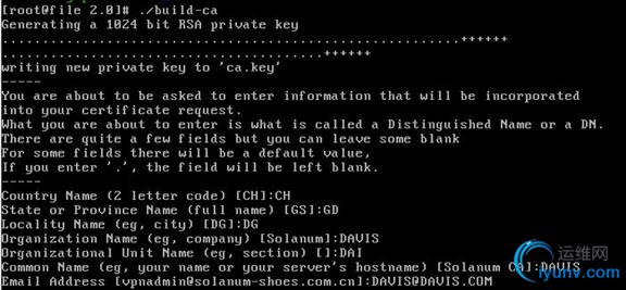

  ./clean-all
  ./build-ca

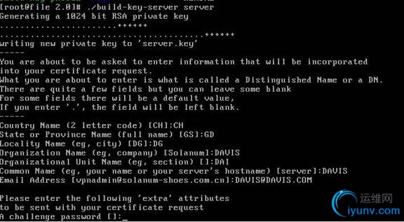

  ./build-key-server server

  Cp server keys

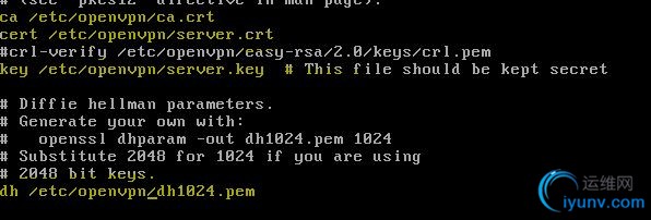

  Cp dh
  Vi /etc/open***/server.conf
