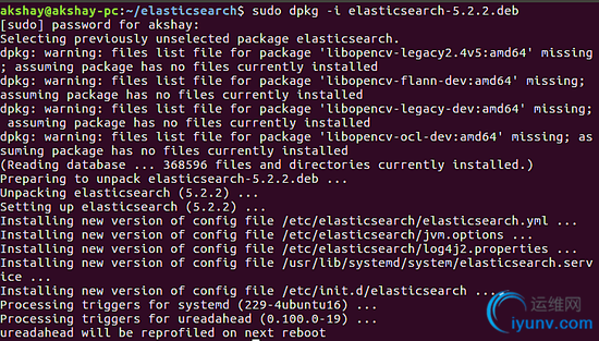

  Once the download is successfully completed, we can install it by running the following command. The output of successful installation is below.
  sudo dpkg -i elasticsearch-5.2.2.deb

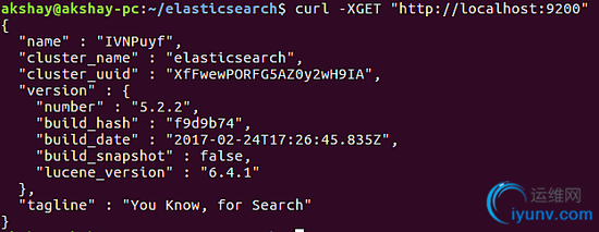

  These three commands add the Elasticsearch process to the system daemon so that it will automatically start when your system boots up and then it restarts the process itself. To test if the system is up and running, use the following command. The output should be similar to the image shown below.
  curl -XGET "http://localhost:9200"

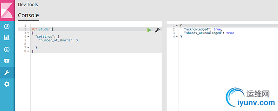

6.1 Create an Index
  Data is stored in an index. To create an index, we use the PUT command. The request JSON will contain the name of the index and some optional settings that we can provide. The following command is an example to create an index called "student".
PUT student
"settings": {
"number_of_shards": 3
  You can type this on the "Dev Tools" and press the green play button beside it to run it.  The output will be similar to the image below:

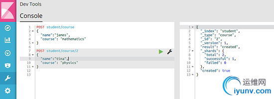

6.2 Insert some data to index
  We will be using the POST calls to insert data to index. The data to be inserted is in the form of JSON and so let us go ahead add students to the index. The Command is :
POST student/course
"name":"james",
"course": "mathematics"
  In the above command, "course" indicates the type of data that is being indexed. From the response, you can see that, this entry has got a unique>POST student/course/2
"name":"tina",
"course": "physics"
  Following are the images that show the response from the search engine when both the commands are run:
