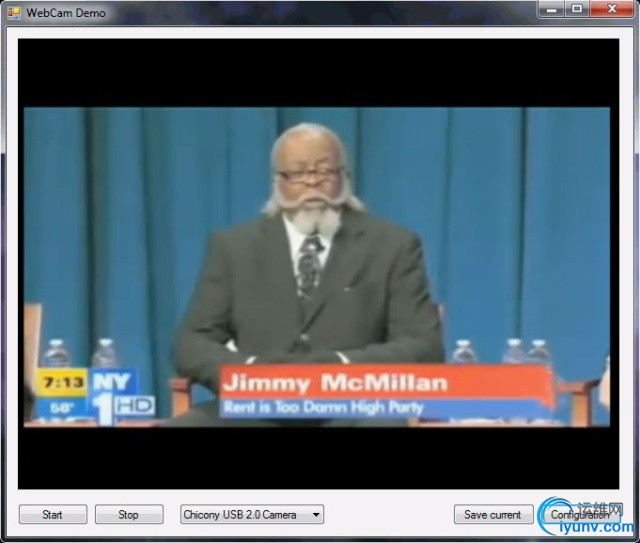

  Now that all that is implemented, we just StartFrameCapture and enjoy the view from our WebCam. Try it out – press F5 and then click the ‘Start’ button once the Form loads up.

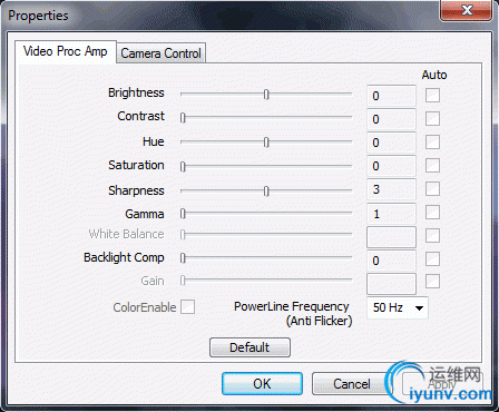

  And bringing up the configuration dialog:
private void btnConfig_Click(object sender, EventArgs e)
// snap camera
if (_frameSource != null)
_frameSource.Camera.ShowPropertiesDialog();
