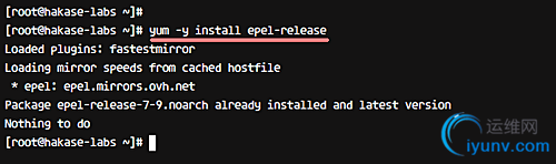

  In this step, we will install the Nginx web server from the EPEL (Extra Packages for Enterprise Linux) repository. Before installing Nginx, make sure the EPEL repository has been installed on your server.
  If you do not have it, you can install it using the command below.
  yum -y install epel-release

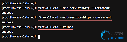

  After the installation, open HTTP and HTTPS ports using the firewall-cmd command below.
  firewall-cmd --add-service=http --permanent
  firewall-cmd --add-service=https --permanent
  firewall-cmd --reload

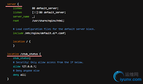

  Next, edit the nginx configuration file 'nginx.conf' to enable the 'stub_status' module. Go to the '/etc/nginx/' directory and edit the configuration with vim.
  cd /etc/nginx/
  vim nginx.conf
  Paste the following configuration inside the 'server {}' block.
    location /stub_status {
         stub_status;
         # Security: Only allow access from the IP below.
         allow 127.0.0.1;
         # Deny anyone else
         deny all;
  Save and exit.

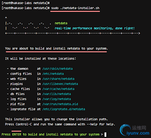

  Go to the netdata directory and run the Netdata installer script with sudo privileges.
  cd netdata/
  sudo ./netdata-installer.sh
  Press 'Enter' to continue with the Nedata installation.

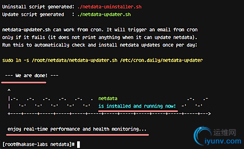

  And when the installation is complete, you will see the result as below.
  Netdata has been installation on CentOS 7, and it's running on port '19999'.

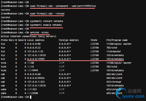

  Open the port using the firewall-cmd command below.
  sudo firewall-cmd --permanent --add-port=19999/tcp
  sudo firewall-cmd --reload
  Netdata provides a systemd services script, so you can manage Netdata using the systemctl command. Restart netdata and enable it to launch automatically every time at system boot.
  systemctl restart netdata
  systemctl enable netdata
  Check the opened port of the server - make sure you get the port 19999 on the 'LISTEN' state.
  netstat -plntu

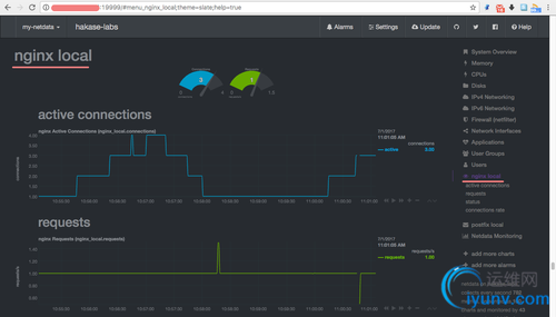

  Open your web browser and visit the server IP address with port 19999.
  http://192.168.1.11:19999/
  And you will get the Netdata Dashboard.
  Click on the 'nginx local' on the right, and see Nginx active connections, requests, status and the connection rate.
