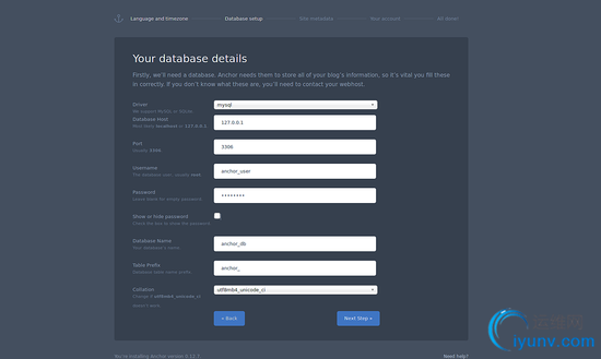

  Provide your database details, then click on the Next Step button. You should see the following page:
