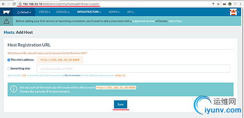

  Next, we will add the rancher-host01 to the Rancher Server.
  Open the Rancher Dashboard, move your cursor to the 'INFRASTRUCTURE' menu and click 'Hosts'.
  Now click 'Add Host' button.
  For the Host Registration URL, we will use default as below.
  Click the 'Save' button.

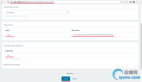

  In this step, we will try to deploy a simple blog platform 'Ghost' as a container through the Rancher Catalog Community Templates.
  On the Rancher Dashboard, move the cursor to the 'CATALOG' menu and click the Community Catalog.
  I the 'Search' box - type the application name that we want to install ('Ghost'), then click the 'View Details' button.
  Give the new Ghost container a name and description.
  Then click the 'Launch' button.

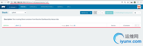

  When it's complete, you will get the result as below.
  The 'Ghost' container has been created and is now running on the Rancher agent server.
  Now move your cursor to the 'INFRASTRUCTURE' menu and click the 'Host'. And make sure you get the 'ghost' container is running on the 'host2' server.

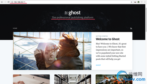

  To verify the Ghost container installation, open your web browser and type the 'rancher-host01' IP address and you will get the ghost blog default homepage.
  http://192.168.33.11/
