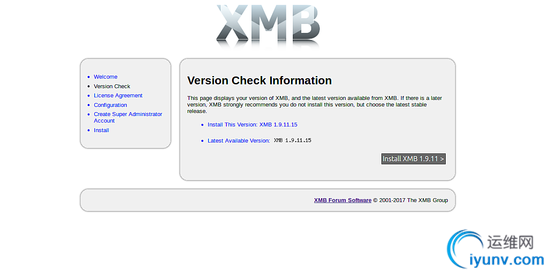

  Now, click on the Start Installation button to start the installation, you should see the following page:
  Here, choose the latest XMB version and click on the Install XMB button, you should see the following page:

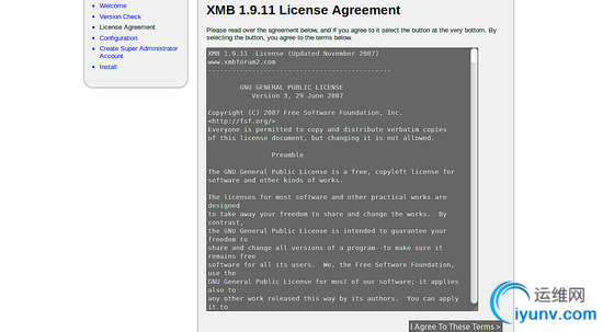

  Here, accept the License agreement and click on the I Agree to These Terms button, you should see the following page:

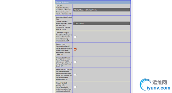

  Here, provide all the required information like, Database name, Database username, Database type, SMTP username and password, then click on the Configure button, you should see the PHP code to your screen, copy this code to config.php file and upload this file to the /var/www/html/xmb/files/ directory. Then click on the Next button, you should see the following page:

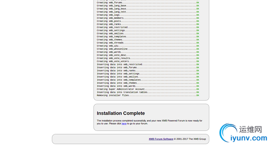

  Here, provide Admin username and password, then click on the Begin Installation button, Once the installation is completed, you should see the following page:
  Now, click on Please click here to go to your forum button, you should see the following page:

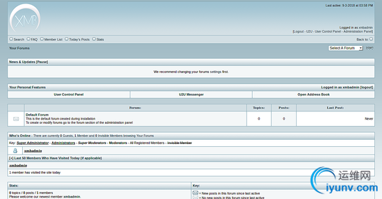

  Now, click on Login button, you should see the XMB forum login page as below:
  Now, enter your XMB admin credential and click on the Login button, you should see the XMB forum dashboard in the following page:
