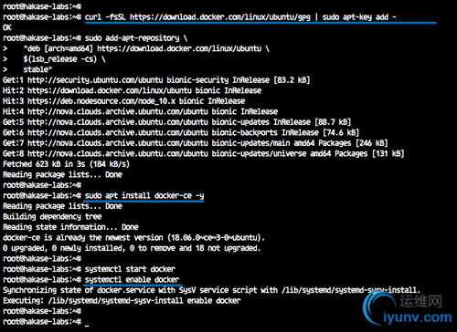

Step 1 - Install Docker CE on Ubuntu 18.04 LTS
  The first step we will do in this tutorial is to install the latest docker-ce version of the system. The docker-ce version can be installed from the official docker repository.
  Add the docker key and docker-ce repository.
  curl -fsSL https://download.docker.com/linux/ubuntu/gpg | sudo apt-key add -
  sudo add-apt-repository \
  "deb [arch=amd64] https://download.docker.com/linux/ubuntu \
  $(lsb_release -cs) \
  stable"
  The command will automatically update all repositories on the system.
  Now install docker using the apt command below.
  sudo apt install docker-ce -y
  After the installation is complete, start the docker service and enable it to launch every time at system startup.
  systemctl start docker
  systemctl enable docker
  The latest docker-ce version has been installed on the Ubuntu 18.04 system.

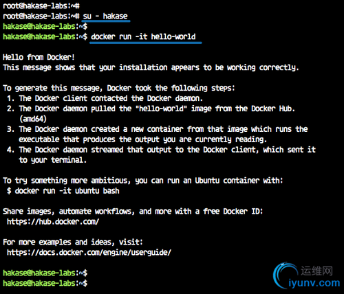

  The 'hakase' can now run the docker container and run the sudo command for root privileges.
  Login as user 'hakase' and run the docker hello-world container.
  su - hakase
  docker run -it hello-world
  And following is the result.

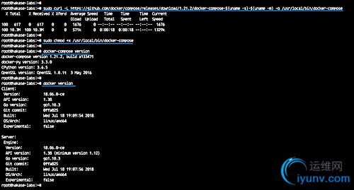

  In this tutorial, we will install the docker compose 1.21 from a binary file on Github repository.
  Download the docker-compose binary to the '/usr/local/bin' directory.
  sudo curl -L https://github.com/docker/compose/releases/download/1.21.2/docker-compose-$(uname -s)-$(uname -m) -o /usr/local/bin/docker-compose
  And make the 'docker-compose' file executable by changing the file permission.
  sudo chmod +x /usr/local/bin/docker-compose
  The docker compose has been installed - check it using the command below.
  docker-compose version
  docker version
  Docker-compose 1.21 with Docker-ce 1.18 has been installed.

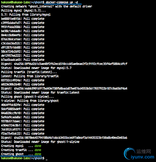

Step 5 - Deploy Ghost with MySQL and Traefik
  To build and run all our ghost stack service, we can use the command below.

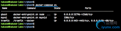

  docker-compose up -d
  When it's complete, check all running services.
  docker-compose ps
  And the following is the result.
  If you have an error, check the container log using commands below.
  docker-compose logs mysql
  docker-compose logs traefik
  docker-compose logs ghost
  The ghost stack with MySQL and the Traefik reverse proxy is up and running.

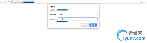

  Open the Traefik dashboard with its URL, mine is http://traef.hakase-labs.io/
  Log in with the user and password on the 'traefik.toml' file.

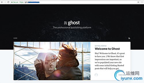

  For the Ghost installation, type the ghost URL on the address bar, mine is http://gho.hakase-labs.io/
  And you will get the ghost home page.

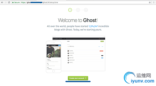

  Now visit the admin page to set up and configure a new admin user. My URL is: http://gho.hakase-labs.io/admin/
  Click the green button to create a new admin user.

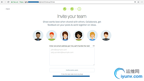

  Type detail user, password, email, and click again the green button.
  For inviting a new member or user, click the 'I will do this later..' link.
