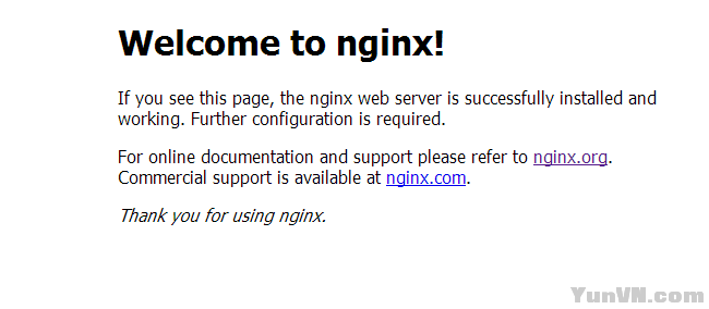

4、 启动服务并测试,(注意iptables规则可能阻止访问):
[iyunv@ASANGE ~]# service nginx start
正在启动 nginx:                                           [确定]
   nginx配置成功!

  启动php-fpm,重启nginx
[iyunv@ASANGE ~]# service php-fpm start
Starting php-fpm  done
[iyunv@ASANGE ~]# service nginx restart
nginx: the configuration file /etc/nginx/nginx.conf syntax is ok
nginx: configuration file /etc/nginx/nginx.conf test is successful
停止 nginx:                                               [确定]
正在启动 nginx:tig
   添加php测试页面:
[iyunv@ASANGE ~]# vim /usr/html/index.php
<?php
phpinfo();
浏览器上访问:
[Shell] 纯文本查看 复制代码
   12、安装php加速器。
