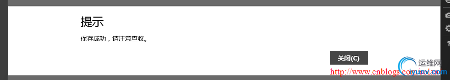

  (2)带有标题的对话框
            MessageDialog md = new MessageDialog("保存成功,请注意查收。", "提示");
  效果图:

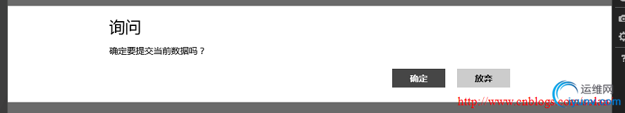

       MessageDialog md = new MessageDialog("确定要提交当前数据吗?", "询问");
md.Commands.Add(new UICommand("确定", cmd =>
Debug.WriteLine("确定");
md.Commands.Add(new UICommand("放弃", cmd =>
Debug.WriteLine("放弃");
md.ShowAsync();
  效果图:
