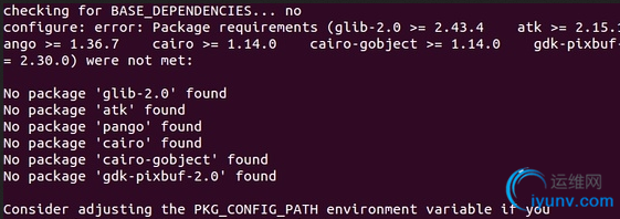

$ ./configure --prefix=/opt/gtk
编译GTK需要依赖 glib、atk、pango、cairo、gdk-pixbuf等软件包。

由于未采取默认配置,设置了自定义安装目录,因此需要声明变量PKG_CONFIG_PATH和LD_LIBRARY_PATH
以glib为例,.pc文件位于 package/lib/pkgconfig目录下,则添加文件set_pkg_config_path_glib-2.0声明PKG_CONFIG_PATH变量和LD_LIBRAY_PATH
$cat /opt/glib-2.44.1/set_pkg_config_path_glib-2.0
export PKG_CONFIG_PATH=/opt/glib-2.44.1/lib/pkgconfig:$PKG_CONFIG_PATH
export LD_LIBRARY_PATH=/opt/glib-2.44.1/lib:$LD_LIBRAY_PATH
         对其它的五个package(atk、cairo、pango、cairo-gobject、gdk-pixbuf-2.0)依次采用针对glib-2.0的编译安装和配置方法,解决GTK对多个库依赖问题。

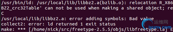

     编译freetype出错:
     一般是64位系统出现此问题,Makefile中CFLAGS加参数-fPIC,使用64位元的方法进行编译。

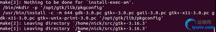

$sudo make
$sudo make install
安装成功:

Suggested packages:
  autoconf2.13 autoconf-archive gnu-standards autoconf-doc dh-make
  apparmor-easyprof docbook-defguide psgml jadetex docbook-dsssl-doc dbtoepub
  docbook-xsl-doc-html docbook-xsl-doc-pdf docbook-xsl-doc-text
  docbook-xsl-doc docbook-xsl-saxon fop libsaxon-java libxalan2-java
  libxslthl-java xalan doxygen-latex doxygen-doc doxygen-gui unrar evolution
  evolution-data-server-dbg python-doc graphviz-doc lrzip libatkmm-1.6-doc
  libcairomm-1.0-doc libchamplain-doc libclutter-gst-doc libgck-1-doc
  libgcr-3-doc libgeocode-glib-doc libgirepository1.0-doc libglibmm-2.4-doc
  gstreamer0.10-doc libgtkmm-3.0-doc libdata-dump-perl libice-doc
  libjson-glib-doc libtool-doc libcrypt-ssleay-perl ttf-baekmuk
  ttf-arphic-gbsn00lp ttf-arphic-bsmi00lp ttf-arphic-gkai00mp
  ttf-arphic-bkai00mp imagemagick libpeas-doc librsvg2-doc seed-doc
  libsigc++-2.0-doc libsm-doc libsoup2.4-doc sqlite3-doc automaken gfortran
  fortran95-compiler gcj-jdk libauthen-ntlm-perl libxcb-doc libxext-doc
  network-manager-openconnect-gnome network-manager-openvpn-gnome
  network-manager-vpnc-gnome libmail-box-perl python-beaker python-mako-doc
  perlsgml w3-recs opensp
The following NEW packages will be installed:
  autoconf automake autopoint autotools-dev debhelper devhelp devhelp-common
  dh-apparmor docbook docbook-dsssl docbook-to-man docbook-xml docbook-xsl
  doxygen evolution-data-server-dev gir1.2-brasero-3.0 gir1.2-caribou-1.0
  gir1.2-champlain-0.12 gir1.2-clutter-1.0 gir1.2-clutter-gst-1.0
  gir1.2-cogl-1.0 gir1.2-coglpango-1.0 gir1.2-evince-3.0 gir1.2-farstream-0.2
  gir1.2-folks-0.6 gir1.2-gck-1 gir1.2-gconf-2.0 gir1.2-gcr-3
  gir1.2-gdesktopenums-3.0 gir1.2-gee-0.8 gir1.2-geocodeglib-1.0
  gir1.2-gkbd-3.0 gir1.2-gnomedesktop-3.0 gir1.2-gst-plugins-base-0.10
  gir1.2-gstreamer-0.10 gir1.2-gtk-2.0 gir1.2-gtkchamplain-0.12
  gir1.2-gtkclutter-1.0 gir1.2-gtop-2.0 gir1.2-gucharmap-2.90
  gir1.2-gweather-3.0 gir1.2-gxps-0.1 gir1.2-json-1.0 gir1.2-mutter-3.0
  gir1.2-nautilus-3.0 gir1.2-nmgtk-1.0 gir1.2-panelapplet-4.0 gir1.2-rest-0.7
  gir1.2-rsvg-2.0 gir1.2-telepathyglib-0.12 gir1.2-xkl-1.0 gjs gnome-api-docs
  gnome-common gnome-core-devel gnome-devel-docs gnome-js-common
  gnome-platform-devel gobject-introspection graphviz
  gsettings-desktop-schemas-dev gstreamer1.0-doc gtk-doc-tools intltool
  itstool jade libarchive-dev libatk-bridge2.0-dev libatk1.0-dev libatk1.0-doc
  libatkmm-1.6-dev libatspi2.0-dev libbrasero-media3-dev
  libcairo-script-interpreter2 libcairo2-dev libcairo2-doc libcairomm-1.0-dev
  libcamel1.2-dev libcanberra-doc libcaribou-common libcaribou-dev libcaribou0
  libcdt5 libcgraph6 libchamplain-0.12-0 libchamplain-0.12-dev
  libchamplain-gtk-0.12-0 libchamplain-gtk-0.12-dev libclutter-1.0-dev
  libclutter-1.0-doc libclutter-gst-1.0-0 libclutter-gst-dev
  libclutter-gtk-1.0-dev libclutter-gtk-1.0-doc libcogl-dev libcogl-doc
  libcogl-pango-dev libcroco3-dev libdbus-1-dev libdbus-glib-1-dev
  libdconf-dev libdconf-doc libdevhelp-3-2 libdrm-dev libebackend1.2-dev
  libebook-contacts1.2-dev libebook1.2-dev libecal1.2-dev libedata-book1.2-dev
  libedata-cal1.2-dev libedataserver1.2-dev libegl1-mesa-dev
  libencode-locale-perl libevince-dev libexpat1-dev libfarstream-0.2-dev
  libffi-dev libfile-listing-perl libfolks-dev libfont-afm-perl
  libfontconfig1-dev libfreetype6-dev libgail-3-dev libgail-3-doc libgail-dev
  libgail-doc libgbm-dev libgck-1-dev libgconf2-dev libgconf2-doc libgcr-3-dev
  libgdk-pixbuf2.0-dev libgdk-pixbuf2.0-doc libgee-0.8-dev libgeocode-glib-dev
  libgeocode-glib0 libgirepository1.0-dev libgjs-dev libgjs0e libgl1-mesa-dev
  libgles2-mesa-dev libglib2.0-dev libglib2.0-doc libglibmm-2.4-dev
  libgmime-2.6-dev libgnome-bluetooth-dev libgnome-desktop-3-dev
  libgnome-keyring-dev libgnome-menu-3-dev libgnomekbd-dev
  libgstreamer-plugins-base0.10-dev libgstreamer-plugins-base1.0-dev
  libgstreamer0.10-dev libgstreamer1.0-dev libgtk-3-dev libgtk-3-doc
  libgtk2.0-dev libgtk2.0-doc libgtkmm-3.0-dev libgtksourceview-3.0-dev
  libgtksourceview-3.0-doc libgtop2-dev libgucharmap-2-90-dev libgvc6 libgvpr2
  libgweather-3-dev libgxps-dev libharfbuzz-dev libharfbuzz-gobject0
  libhtml-form-perl libhtml-format-perl libhtml-parser-perl
  libhtml-tagset-perl libhtml-tree-perl libhttp-cookies-perl
  libhttp-daemon-perl libhttp-date-perl libhttp-message-perl
  libhttp-negotiate-perl libical-dev libice-dev libio-html-perl
  libjavascriptcoregtk-3.0-dev libjson-glib-dev libltdl-dev
  liblwp-mediatypes-perl liblwp-protocol-https-perl libmail-sendmail-perl
  libmirclient-dev libmirclient7 libmirclientplatform-mesa libmirprotobuf-dev
  libmirprotobuf0 libmozjs-24-0 libmozjs-24-bin libmozjs-24-dev libmutter-dev
  libmutter0c libnautilus-extension-dev libnet-http-perl libnm-glib-dev
  libnm-gtk-dev libnm-util-dev libnotify-dev libnotify-doc libnspr4-dev
  libnss3-dev libp11-kit-dev libpanel-applet-4-0 libpanel-applet-4-dev
  libpanel-applet-4-doc libpango1.0-dev libpango1.0-doc libpangomm-1.4-dev
  libpathplan4 libpcre3-dev libpcrecpp0 libpeas-dev libpixman-1-dev
  libpng12-dev libprotobuf-dev libprotobuf-lite8 libpthread-stubs0-dev
  libpython-dev libpython2.7-dev librest-dev librsvg2-dev libsecret-1-dev
  libseed-gtk3-0 libseed-gtk3-dev libsigc++-2.0-dev libsigsegv2 libsm-dev
  libsoup-gnome2.4-dev libsoup2.4-dev libsp1c2 libsqlite3-dev
  libstartup-notification0-dev libsys-hostname-long-perl libtasn1-3-bin
  libtasn1-3-dev libtasn1-6-dev libtasn1-bin libtelepathy-farstream-dev
  libtelepathy-glib-dev libtelepathy-glib-doc libtool libtotem-plparser-dev
  libudev-dev libudisks2-dev libvala-0.22-0 libvte-2.90-dev libvte-2.90-doc
  libwacom-dev libwayland-dev libwebkitgtk-3.0-dev libwebkitgtk-common-dev
  libwnck-3-dev libwww-perl libwww-robotrules-perl libx11-dev libx11-doc
  libx11-xcb-dev libxau-dev libxcb-dri2-0-dev libxcb-dri3-dev libxcb-glx0-dev
  libxcb-present-dev libxcb-randr0-dev libxcb-render0-dev libxcb-shape0-dev
  libxcb-shm0-dev libxcb-sync-dev libxcb-xfixes0-dev libxcb1-dev
  libxcomposite-dev libxcursor-dev libxdamage-dev libxdmcp-dev libxext-dev
  libxfixes-dev libxft-dev libxi-dev libxinerama-dev libxkbcommon-dev
  libxkbfile-dev libxklavier-dev libxml-parser-perl libxml2-dev libxml2-doc
  libxml2-utils libxrandr-dev libxrender-dev libxres-dev libxshmfence-dev
  libxtst-dev libxxf86vm-dev m4 mesa-common-dev mircommon-dev mm-common
  mutter-common network-manager-dev po-debconf policykit-1-doc python-dev
  python-gi-dev python-gobject-2-dev python-gobject-dev python-mako
  python-markupsafe python2.7-dev sgml-data sp valac valac-0.22
  valac-0.22-vapi x11proto-composite-dev x11proto-core-dev x11proto-damage-dev
  x11proto-dri2-dev x11proto-fixes-dev x11proto-gl-dev x11proto-input-dev
  x11proto-kb-dev x11proto-randr-dev x11proto-record-dev x11proto-render-dev
  x11proto-resource-dev x11proto-xext-dev x11proto-xf86vidmode-dev
  x11proto-xinerama-dev xorg-sgml-doctools xsltproc xtrans-dev yelp-tools
  zlib1g-dev
The following packages will be upgraded:
  evince evolution-data-server evolution-data-server-common
  evolution-data-server-online-accounts gir1.2-ebook-1.2
  gir1.2-ebookcontacts-1.2 gir1.2-edataserver-1.2 gir1.2-freedesktop
  gir1.2-glib-2.0 gir1.2-gnomebluetooth-1.0 gir1.2-gtk-3.0
  gir1.2-javascriptcoregtk-3.0 gir1.2-networkmanager-1.0 gir1.2-pango-1.0
  gir1.2-webkit-3.0 gir1.2-wnck-3.0 gnome-bluetooth gnome-desktop3-data
  libarchive13 libcairo-gobject2 libcairo2 libcamel-1.2-45
  libclutter-gtk-1.0-0 libdbus-1-3 libdrm-intel1 libdrm-nouveau2
  libdrm-radeon1 libdrm2 libebackend-1.2-7 libebook-1.2-14
  libebook-contacts-1.2-0 libecal-1.2-16 libedata-book-1.2-20
  libedata-cal-1.2-23 libedataserver-1.2-18 libegl1-mesa libegl1-mesa-drivers
  libevdocument3-4 libevview3-3 libfreetype6 libgail-3-0 libgail-common
  libgail18 libgbm1 libgirepository-1.0-1 libgl1-mesa-glx libglapi-mesa
  libgles2-mesa libglib2.0-0 libglib2.0-bin libgnome-bluetooth11
  libgnome-desktop-3-7 libgtk-3-0 libgtk2.0-0 libgtk2.0-bin libgweather-3-6
  libharfbuzz-icu0 libharfbuzz0b libjavascriptcoregtk-3.0-0
  libnautilus-extension1a libnm-glib4 libnm-gtk-common libnm-gtk0 libnm-util2
  libnspr4 libnss3 libnss3-1d libnss3-nssdb libpango-1.0-0 libpango1.0-0
  libpangocairo-1.0-0 libpangoft2-1.0-0 libpangoxft-1.0-0 libtasn1-6 libudev1
  libwayland-egl1-mesa libwebkitgtk-3.0-0 libwebkitgtk-3.0-common libwnck-3-0
  libxext6 libxfixes3 libxi6 libxml2 libxrender1 network-manager-gnome
  python-gi python-gi-cairo python3-gi python3-gi-cairo udev
90 upgraded, 337 newly installed, 0 to remove and 344 not upgraded.
Need to get 118 MB of archives.
After this operation, 507 MB of additional disk space will be used.
Do you want to continue? [Y/n]
