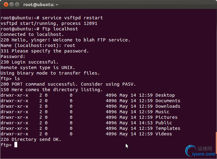

  3.create file vsftpd.chroot_list  (my decision: enable root account )
# vsftpd userlist
# If userlist_deny=NO, only allow users in this file
# If userlist_deny=YES (default), never allow users in this file, and
# do not even prompt for a password.
# Note that the default vsftpd pam config also checks /etc/vsftpd/ftpusers
# for users that are denied.
#root  (comment this,enable root account)
bin
daemon
adm
lp
sync
shutdown
halt
mail
news
uucp
operator
games
nobody
  4. edit file ftpuses in directory /etc , enable root
# /etc/ftpusers: list of users disallowed FTP access. See ftpusers(5).
#root
daemon
bin
sys
sync
games
man
lp
mail
news
uucp
nobody

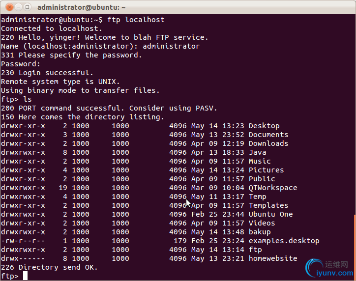

  5. restart vsftpd,and connect with root account (reminder: you can enable root account simply change root account and login in with root ,have a try)
  by default, the ftp root directory is the user's home directory !
  login with another account
