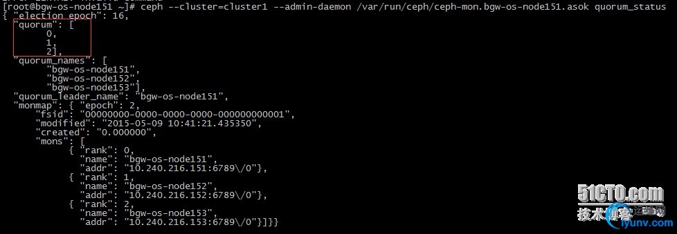

首先看看故障前的仲裁状态信息:
[iyunv@bgw-os-node151 ~]# ceph--cluster=cluster1 --admin-daemon /var/run/ceph/ceph-mon.bgw-os-node151.asokquorum_status
再来看看故障后的仲裁状态信息:

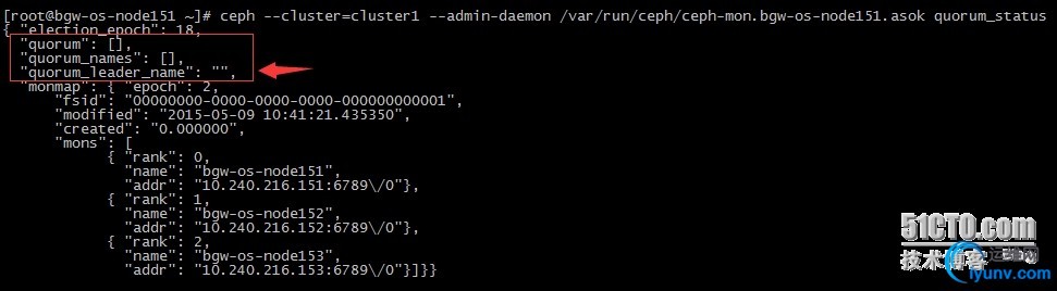

[iyunv@bgw-os-node151 ~]# ceph--cluster=cluster1 --admin-daemon /var/run/ceph/ceph-mon.bgw-os-node151.asokconfig show
此时通过网络访问ceph的所有操作都会被阻塞,但是在monitor本地的socket还是可以通信的。

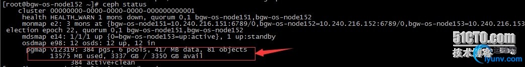

[iyunv@bgw-os-node152 ~]# ceph-mon --clustercluster1 -i bgw-os-node152 --public-addr 10.240.216.152:6789 -c /etc/ceph/ceph.conf
[iyunv@bgw-os-node152 ~]# ps aux | grep mon
dbus     2968  0.0  0.0 21588  2408 ?        Ss  May08   0:00 dbus-daemon --system
root    14717  1.0  0.0 165792 30768 pts/0    Sl  16:33   0:00 ceph-mon --clustercluster1 -i bgw-os-node152 --public-addr 10.240.216.152:6789 -c/etc/ceph/ceph.conf
root    14732  0.0  0.0 103308 2092 pts/0    S+   16:33  0:00 grep mon
[iyunv@bgw-os-node152 ~]# ceph status
   cluster 00000000-0000-0000-0000-000000000001
    health HEALTH_WARN 1 mons down, quorum 0,1 bgw-os-node151,bgw-os-node152
    monmap e2: 3 mons at{bgw-os-node151=10.240.216.151:6789/0,bgw-os-node152=10.240.216.152:6789/0,bgw-os-node153=10.240.216.153:6789/0},election epoch 22, quorum 0,1 bgw-os-node151,bgw-os-node152
    mdsmap e14: 1/1/1 up {0=bgw-os-node153=up:active}, 1 up:standby
    osdmap e98: 12 osds: 12 up, 12 in
     pgmap v12319: 384 pgs, 6 pools, 417 MB data, 81 objects
           13575 MB used, 3337 GB / 3350 GB avail
                384 active+clean
数据正常:)

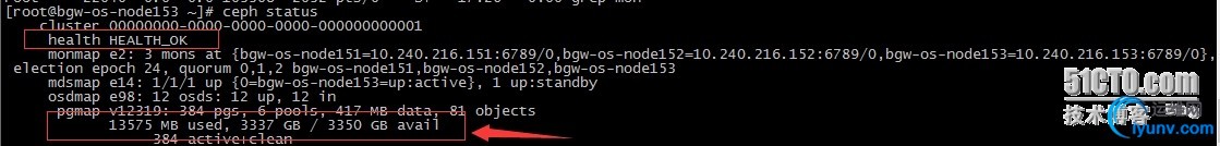

[iyunv@bgw-os-node153 ~]# ceph-mon --clustercluster1 -i bgw-os-node153 --public-addr 10.240.216.153:6789 -c/etc/ceph/ceph.conf
[iyunv@bgw-os-node153 ~]# ps aux | grep mon
dbus     2215  0.0  0.0 21588  2448 ?        Ss  May08   0:00 dbus-daemon --system
root    22023  1.7  0.1 166580 34096 pts/0    Sl  17:26   0:00 ceph-mon --clustercluster1 -i bgw-os-node153 --public-addr 10.240.216.153:6789 -c/etc/ceph/ceph.conf
root    22040  0.0  0.0 103308 2032 pts/0    S+   17:26  0:00 grep mon
[iyunv@bgw-os-node153 ~]# ceph status
    health HEALTH_OK
    monmap e2: 3 mons at{bgw-os-node151=10.240.216.151:6789/0,bgw-os-node152=10.240.216.152:6789/0,bgw-os-node153=10.240.216.153:6789/0},election epoch 24, quorum 0,1,2 bgw-os-node151,bgw-os-node152,bgw-os-node153
                 384 active+clean
