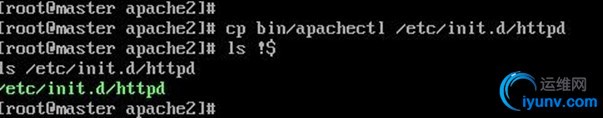

3、lamp连接测试(1)设置service方式启动apache#将启动脚本复制为/etc/init.d/httpd
cp /usr/local/apache2/bin/apachectl /etc/init.d/httpd
#可以这样来停止、启动和重启apache
service httpd stop/start/restart
/etc/init.d/httpd stop/start/restart
/usr/local/apache2/bin/apachectl stop/start/restart
