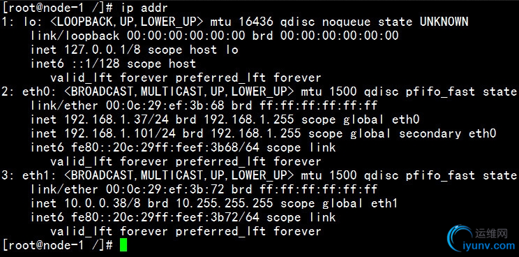

      crm(live)# status
      Last updated: Thu Jun 25 11:37:07 2015
      Last change: Wed Jun 24 18:06:40 2015
      Stack: classic openais (with plugin)
      Current DC: node-1 - partition with quorum
      Version: 1.1.11-97629de
      2 Nodes configured, 2 expected votes
      2 Resources configured
      Online: [ node-1 node-2 ]
      Resource Group: webgroup
      webserver(lsb:httpd):Started node-2
      webip(ocf::heartbeat:IPaddr):Started node-2
     Failed actions:
     webserver_monitor_30000 on node-2 'not running' (7): call=11, status=complete, last-rc-change='Thu Jun 25 10:52:04 2015', queued=0ms, exec=16ms
     webserver_start_0 on node-1 'unknown error' (1): call=14, status=complete, last-rc-change='Thu Jun 25 10:51:59 2015', queued=0ms, exec=205ms

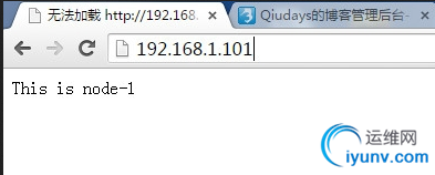

测试HA的可用性:
       1、查看资源是否可以正常工作
   2、将网卡或服务关掉,看它是否会将资源转移或尝试重新启动资源
      [iyunv@node-1/]# ifconfig eth0 down
