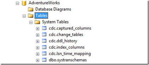

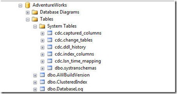

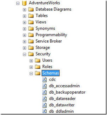

  Additionally, in the database AdventureWorks, you will see that a schema with the name ‘cdc’ has now been  created.
  Some System Tables will have been created within the  AdventureWorks database as part of the cdc schema.
  The table which have been created are listed here.
  • cdc.captured_columns – This table returns result for list of captured column.
  • cdc.change_tables – This table returns list of all the tables which are enabled for capture.
  • cdc.ddl_history – This table contains history of all the DDL changes since capture data enabled.
  • cdc.index_columns – This table contains indexes associated with change table.
  • cdc.lsn_time_mapping – This table maps LSN number (for which we will learn later) and time.

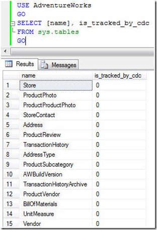

3. Enabling Change Data Capture on one or more Database Tables
  The CDC feature can be applied at the table-level  to any database for which CDC is enabled.  It has to be enabled for any table which needs to be tracked. First run following query to show which tables of database have already been enabled for CDC.
   1: USE AdventureWorks
   2: GO
   3: SELECT [name], is_tracked_by_cdc
   4: FROM sys.tables
   5: GO
  The above query will return a result that includes a column with the  table name, along with a column which displays if CDC is enabled or not.
  You can run the following stored procedure to enable each table. Before enabling CDC at the table level, make sure that you have  enabled SQL Server Agent. When CDC is enabled on a table, it creates two CDC-related jobs that are specific to the database,  and executed using SQL Server Agent. Without SQL Server Agent enabled, these jobs will not execute.

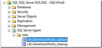

  As we are using AdventureWorks database, it creates the jobs with following names.
  1. cdc.AdventureWorks_capture – When this job is executed it runs the system stored procedure sys.sp_MScdc_capture_job.  The procedure sys.sp_cdc_scan  is called internally by sys.sp_MScdc_capture_job. This procedure cannot be executed explicitly when a change data capture log scan operation is already active or when the database is enabled for transactional replication. This system SP enables SQL Server Agent, which in facts enable Change Data Capture feature.
  2. cdc.AdventureWorks_cleanup – When this job is executed it runs the system stored procedure sys.sp_MScdc_cleanup_job. This system SP cleans up database changes tables.

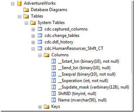

  When everything is successfully completed,  check  the system tables again and you will find a new table  called cdc.HumanResources_Shift_CT. This table will contain all the changes in the table HumanResources.Shift. If you expand this table, you will find five additional columns as well.

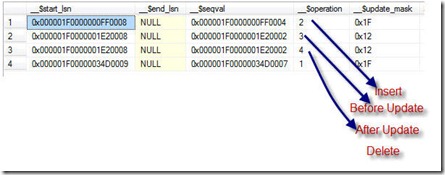

  As you will see there are five additional columnsto the mirrored original table
  • __$start_lsn
  • __$end_lsn
  • __$seqval
  • __$operation
  • __$update_mask
  There are two values which are very important to us is __$operation and __$update_mask.
  Column _$operation contains value which corresponds to DML Operations. Following is quick list of value and its corresponding meaning.
  • Delete Statement = 1
  • Insert Statement = 2
  • Value before Update Statement = 3
  • Value after Update Statement = 4
  The column _$update_mask shows, via a bitmap,   which columns were updated in the DML operation that was specified by _$operation.  If this was  a DELETE or INSERT operation,   all columns are updated and so the mask contains value which has all 1’s in it. This mask is contains value which is formed with Bit values.

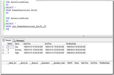

  We will test this feature by doing  DML operations such as INSERT, UPDATE and DELETE on the table HumanResources.Shift which we have set up for CDC. We will observe the effects on the CDC table cdc.HumanResources_Shift_CT.
  Before we start let’s first SELECT from both tables and see what is in them.
   2: GO
   3: SELECT *
   4: FROM HumanResources.Shift
   5: GO
   6: USE AdventureWorks
   7: GO
   8: SELECT *
   9: FROM cdc.HumanResources_Shift_CT
  10: GO
  The result  of the query is as displayed here.
  The original table HumanResources.Shift has three rows in it, whereas the  table cdc.HumanResources_Shift_CT is totally empty. This table will have entries after an operation on the tracked table.

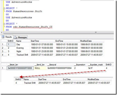

  Insert Operation
   1: Lets run an INSERT operation on the table HumanResources.Shift.
   2:
   3: USE AdventureWorks
   4: GO
   5: INSERT INTO [HumanResources].[Shift]
   6: ([Name],[StartTime],[EndTime],[ModifiedDate])
   7: VALUES ('Tracked Shift',GETDATE(), GETDATE(), GETDATE())
   8: GO
   9:
  Once the script is run, we will check the content of two of our tables HumanResources.Shift and cdc.HumanResources_Shift_CT.
  Because of the INSERT operation, we have a newly inserted fourth row in the tracked table HumanResources.Shift . The tracking table also has the same row visible. The value of _operation is 2 which means that this is an INSERT operation.

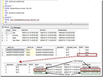

  Update Operation
  To illustrate the effects of an UPDATE we will update a newly inserted row.
   2:
   3: GO
   4:
   5: UPDATE [HumanResources].[Shift]
   6:
   7: SET Name = 'New Name',
   8:
   9:       ModifiedDate = GETDATE()
  10:
  11: WHERE ShiftID = 4
  12:
  13: GO
  14:
  Once more, we check our tables HumanResources.Shift and cdc.HumanResources_Shift_CT.
  UPDATE operations always result in two different entries in the tracking table. One entry contains the previous values before the UPDATE is executed.  The second entry is for new data after the UPDATE is executed. In our case we have only changed two columns of the table but we are tracking the complete table so all the entries in the tableare logged before, and after, the update happens. The Change Data Capture mechanism always captures all the columns of the table unless, when CDC is set up on a table, it is restricted to track only a few columns. We will see how this can be done later on this article.

  It is important to understand the Update mask column in the tracking table. It is named as _$update_mask. The value displayed in the field is hexadecimal but is stored as binary.
  In our example we have three different operations. INSERT and DELETE operations are done on the complete row and not on individual columns. These operations are listed marked masked with 0x1F is translated in binary as 0b11111, which means all the five columns of the table.
  In our example, we had an UPDATE on only two columns – the second and fifth column. This is represented with 0x12 in hexadecimal value ( 0b10010 in binary).  Here, this value stands for second and fifth value if you look at it from the right, as a bitmap. This is a useful way of finding out which columns are being updated or changed.
  The tracking table shows  two columns which contains the suffix lsn in them i.e. _$start_lsn and _$end_lsn. These two values correspond to the  Log Sequential Number. This number is associated with committed transaction of the DML operation on the tracked table.

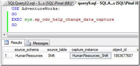

  Disabling this feature is very simple. As we have seen earlier, if we have to enable CDC we have to do this in two steps – at table level and at database level,: In the same way, when we have to disable this feature, we can do this at same two levels. Let us see both of them one after one.
  For dropping any tracking of any table we need three values the Source Schema, the Source Table name, and the Capture Instance. It is very easy to get schema and table name. In our case, the schema is HumanResource and table name is Shift, however we do not know the name of the Capture Instance. We can retrieve it very easily by running following T-SQL Query.
   1: USE AdventureWorks;
   2: GO
   3: EXEC sys.sp_cdc_help_change_data_capture
   4: GO
  this will return a result which contains all the three required information for disabling CDC ona table.
  The Stored Procedure  sys.sp_cdc_help_change_data_capture provides lots of other useful information as well. Once we have name of the capture instance, we can disable tracking of the table by running this T-SQL query.

  So what’s in the system table which will be created by data capturing purpose in AdventureWorks Database?
  So you can see that there are now only two rows which are tracked.

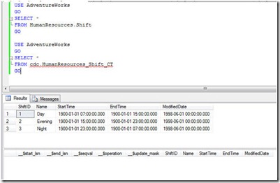

  Before we start let us first select from both of the table and observe its content.
   2: GO
   3: SELECT *
   5: GO
   7: GO
   8: SELECT *
  10: GO
  Here is the result.
  The original table HumanResources.Shift now has three rows in it; whereas  table cdc.HumanResources_Shift_CT is totally empty. Lets update ModifiedDate for ShiftID =1 and see if that record creates an entry in the tracking table.

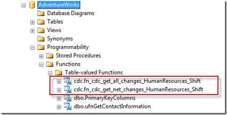

  Before we run this query let us explore two table valued functions (TVF) in AdventureWorks database. You can see that there are two new TVF are created with schema cfc. These functions are created when table level CDC was enabled.
  The function cdc.fn_cdc_get_all_changes_HumanResources_Shift can be used to get events that occurred over a particular time period. You can run this T-SQL script to get event happened during any specific time period. In our case, we will be retrieving this data for the past 24 hours.
  Following query should do retrieve data which was modified in the past 24 hours..

  Automatic Clean Up Process
  If we track every change of all the  data in our database, there is very good chance that we will outgrow the hard drive of main server. This will also lead to issues with maintenance and input/output buffer issues.
  In CDC this there is automatic cleanup process that runs at regular intervals. By default the interval is of 3 days but it can be configured. We have observed that, when we enable CDC on the database, there is one additional system stored procedure created with the  name sys.sp_cdc_cleanup_change_table which cleans up all the tracked data at interval.
