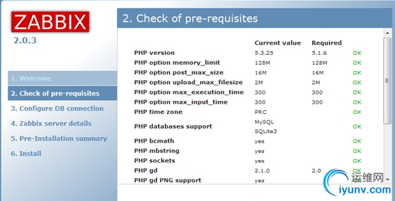

七。安装
http://www.zabbix.com/setup.php
报错
zabbix  PHP time zone unknown   Fail
解决:
#vim /usr/local/php5/etc/php.ini
         date.timezone = PRC
#servicephp-fpm reload
报错:zabbix PHP gettext no Fail
解决:
# cd /usr/local/src/packages/php-5.3.25/ext/gettext
#/usr/local/php5/bin/phpize
#./configure --with-php-config=/usr/local/php5/bin/php-config
# make && make install
extension = "gettext.so"
#service php-fpm reload
