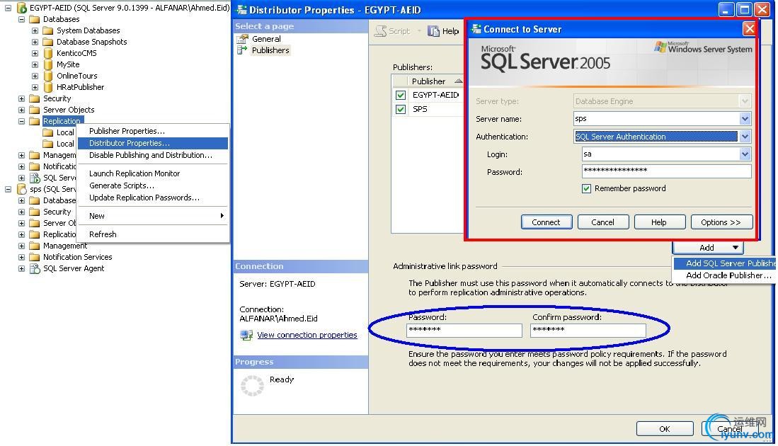

  • Open SQL ServerManagement Studio and login with SQL Server Authentication to configure Publishing, Subscribers, and Distribution
  a- Configure the appropriate server as publisher or distributor.

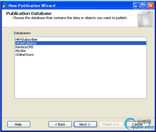

  2- Create new local publication from DB-Server --> Replication --> Local Publications --> Right Click --> New Pub
  then choose the database that contains the data or objects you want to replicate

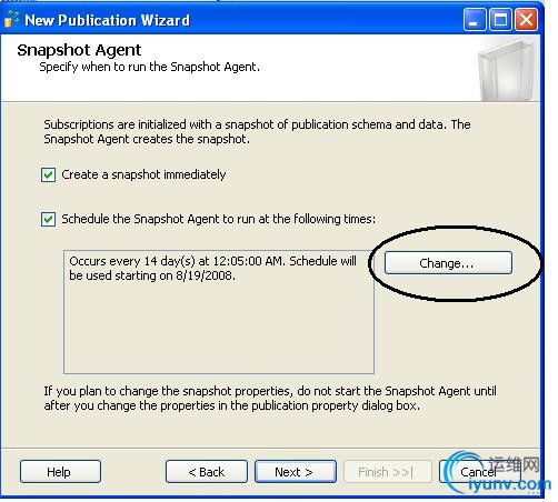

  Then add filters to published tables to optimize performance and then configure the snapshot agent
  and configure the security for snapshot agent

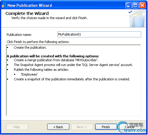

  finally rename the publication and click finish

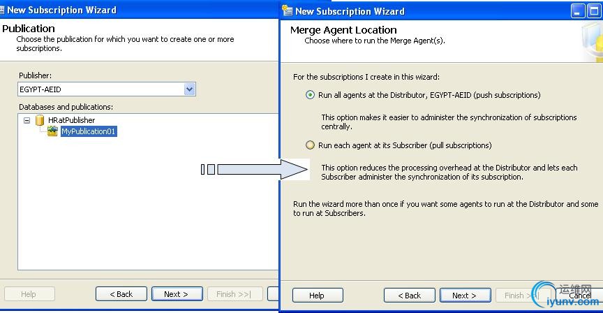

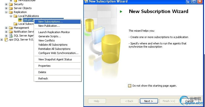

  3- create a new subscription for the created "MyPublication01" Publication by right click on MyPublication01 --> New Subscription
  that to configure the "Merge Agent" for replication on the subscriber database
  then choose one or more subscriber databases. you can add new SQL Server subscribers
  then specify the Merge Agent security as mentioned above on "Agent Snapshot"
  and so specify the synchronization schedule for each agent.
