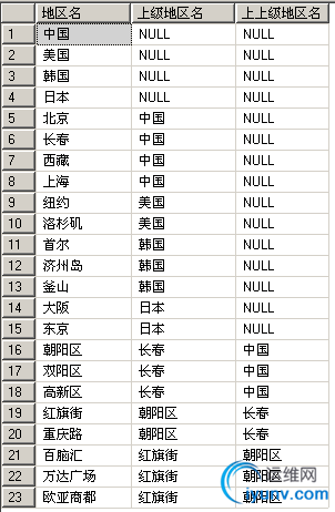

  自连接三级(左联接):
select a.[Name] as '地区名',
       b.[Name] as '上级地区名',
       c.[Name] as '上上级地区名'
from tb_TestTreeView as a
left join tb_TestTreeView as b
     on a.Parent = b.ID
left join tb_TestTreeView as c
     on b.parent=c.id
  结果为:

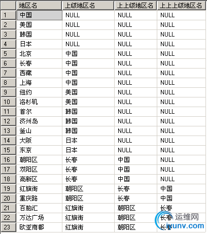

  自连接四级(左链接):
       c.[Name] as '上上级地区名',
       d.[Name] as '上上上级地区名'
     on a.Parent = b.ID
     on b.parent=c.id
left join tb_TestTreeView as d
     on c.parent=d.id
  结果为:

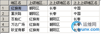

  自连接四级(内链接):
inner join tb_TestTreeView as b
     on a.Parent = b.ID
inner join tb_TestTreeView as c
     on b.Parent = c.ID
inner join tb_TestTreeView as d
     on c.Parent = d.ID
  结果为:
