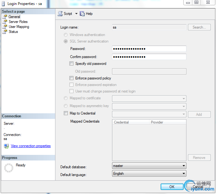

不使用上述语句修改sa账户密码(ps:2012-7-9)
  使用SSMS连接数据库,然后打开Security->Login->sa->propertities,在properties中直接修改即可,如下图示所示:

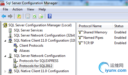

  A connection was successfully established with the server, but then an error occurred during the login process. (provider: Shared Memory Provider, error: 0 - No process is on the other end of the pipe.) (Microsoft SQL Server, Error: 233)
  出现上述错误的原因是有协议没有开,打开sqlserver configure manager,然后在sqlserver network configuration中打开tcp/ip和named piped协议,如下图所示:

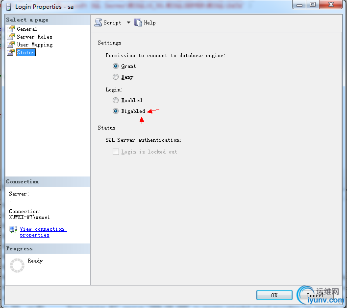

  按照常规方法还是无法登录,这是因为sa账户处于不可用状态,修改如下:将login从Disable修改为Enable
